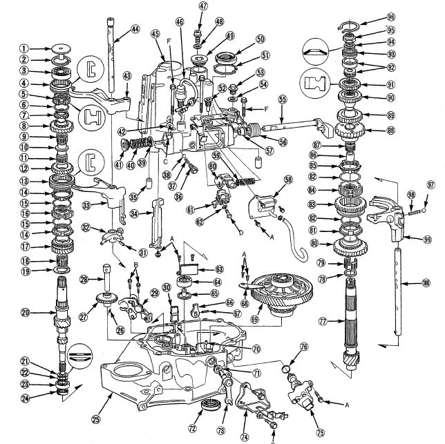

Gearbox rebuilt, still some noise?
So got the gearbox rebuilt. Fair bit done to it, repairs to 1st and 2nd forks, dog teeth on outer hubs repaired and a bearing and seal kit installed.
Also installed brand new genuine clutch kit but for some stupid reason when I release the clutch there is noise.
Now we are guessing that the clutch release bearing is still in gentle contact with the pressure plate fingers perhaps? Gearbox operation is fine otherwise.
Could a failing master or slave cylinder contribute to this? What about the clutch release bearing spring? when I was was inspecting the setup it didn't appear as if it had any effect in returning the bearing, more just to keep the bearing clipped to the fork. If so what is supposed to return the bearing after depressing the clutch. Surely there must be some mechanisim to keep the bearing off the pressure plate fingers when not depressed?
