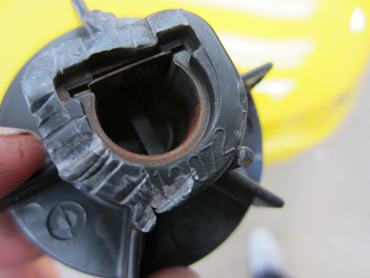

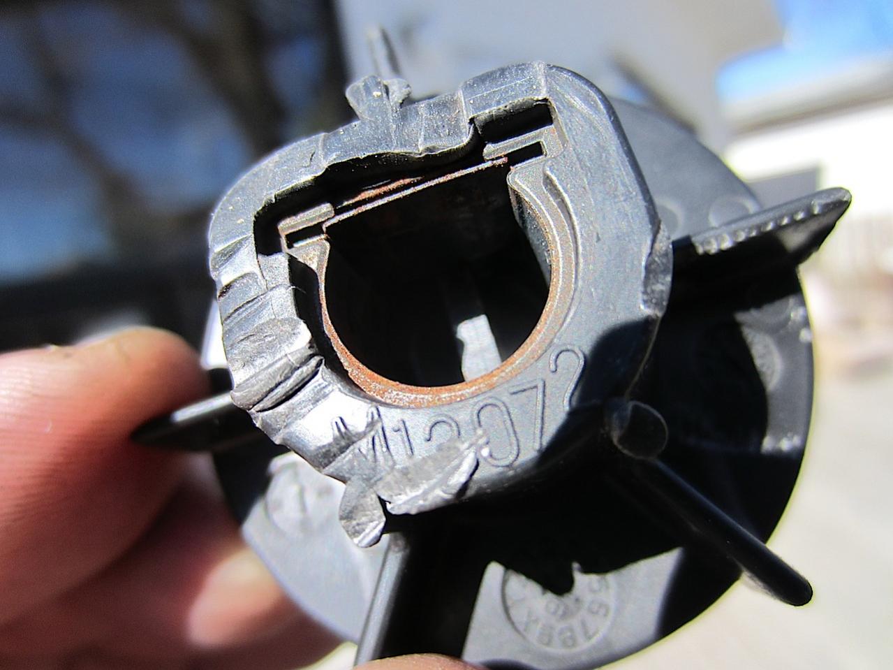

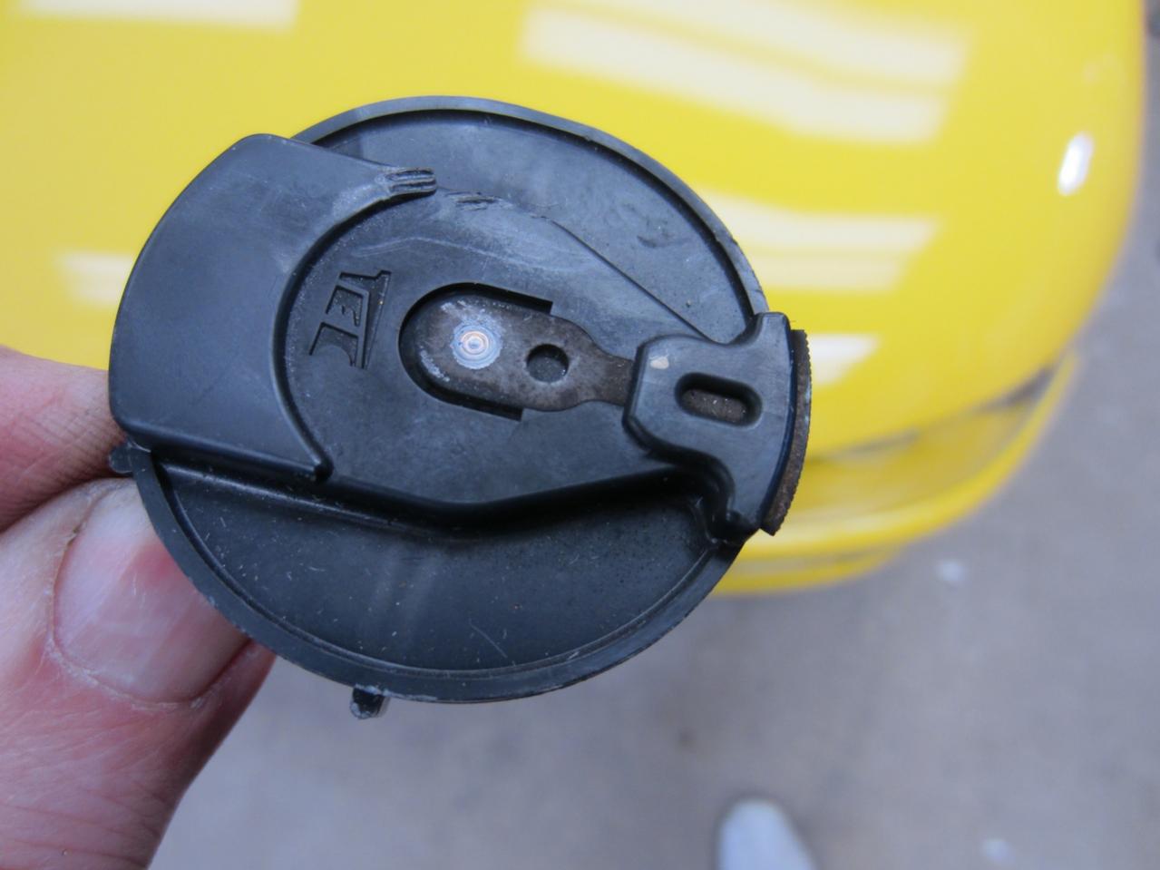

Sorry I took so long to reply, I had to pry my rotor off.Attachment 2583Attachment 2584Attachment 2585
try heating the rotor arm (only ) with a hairdryer worked for me last time
