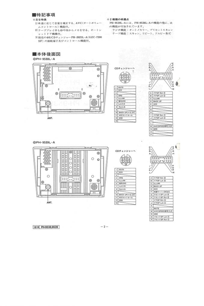

I have recently got my hands on a center speaker assembly, but without its loom...
Does anyone have a pinout of the plug that fits this ??
http://i7.photobucket.com/albums/y29...CCC44B2CB2.jpg
or any advice on what fits ???
