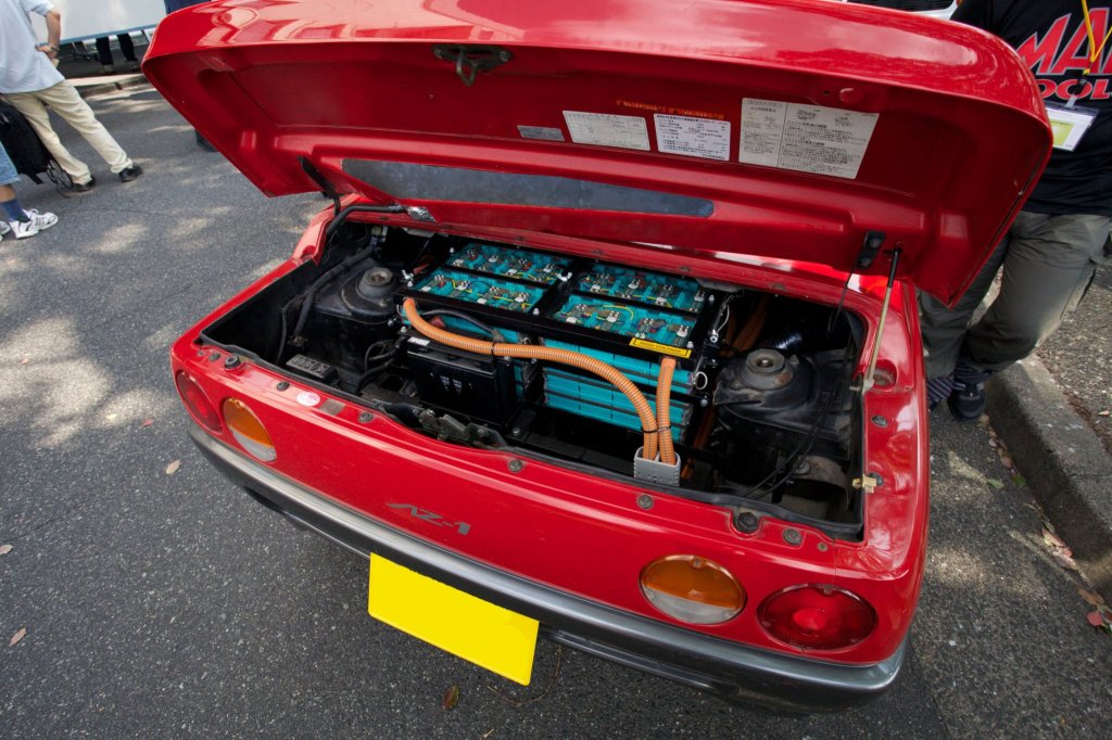

It would appear that your Beat won't be the first EV Kei car. This was takeen at the Mazda factory about 5 years ago but I've no further info about it I'm afraid.
Attachment 2277

It's a Mazda (Autozam) AZ-1 (the 'A' in the ABC of Kei cars). Pic was on one of the japanese forums but I can't find out anything else about the project.

Wow!
I want one of those :-) Gull wings an all! rare as rocking horse S#!t here in the UK, I would love to get my hands on one, also known as the Suzuki Cara. (ebay & general web search came back blank for one to buy)
Why is it that the Japanese make the coolest looking cars in the world? and then make so few of them that you cant get one for love nor money :-(

Graham, if it's any consolation, I have only seen one AZ-1 here in Okinawa. A lady who had no idea about how special it is had gotten it from a relative. I met her in a supermarket carpark where she was filling it up with beer cartons! Seems like I read only a few thousand were ever made.
I did actually go looking for AZ-1s.
They are out there and I found quite a few on Japanese dealers sites, but you're looking at around £6000, plus shipping, plus duty, plus VAT.
I do know of a low mileage immaculate car for sale in the UK. Don't ask for the price without the use of Oxygen.
I got my AZ-1 about 6 years ago when the exchange rate was a lot moe favourable - £6500 on the road in the UK with 17K kms on it, there aren't any bargins like that about anymore.
There were just over 4500 made, 500 of those were badged Suzuki and called the Cara. I think there are still about 2000 left, mostly in Japan
We did have 3 at the annual KKITP meet a few years ago and there were 2 of us there this year - not bad considering there are only 5 in the uk :)
