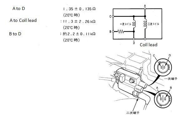

Coil resistances
Attachment 2452

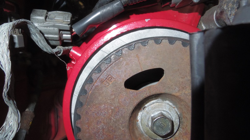

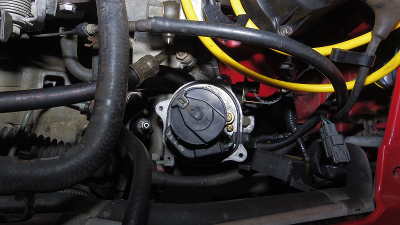

Attachment 2476Attachment 2477Attachment 2478New coil and ICM did not resolve the issue. Car is home now, so starting over all the troubleshooting and i think the timing may be off. Please see attached photos.

It sounds to me as if the static timing is incorrect.
I don't like the sound of the statement "I got the mark as best as i could" that doesn't sound OK
What mark as best as could? What is static position of distributor when engine is on TDC?

I rechecked the timing again, white T mark when the cam pulley is up T marks on the back of the cam pulley line up with the head. Cylinder is all the way up and rocker arms on intake and exhaust are able to shake which means the valves are closed.

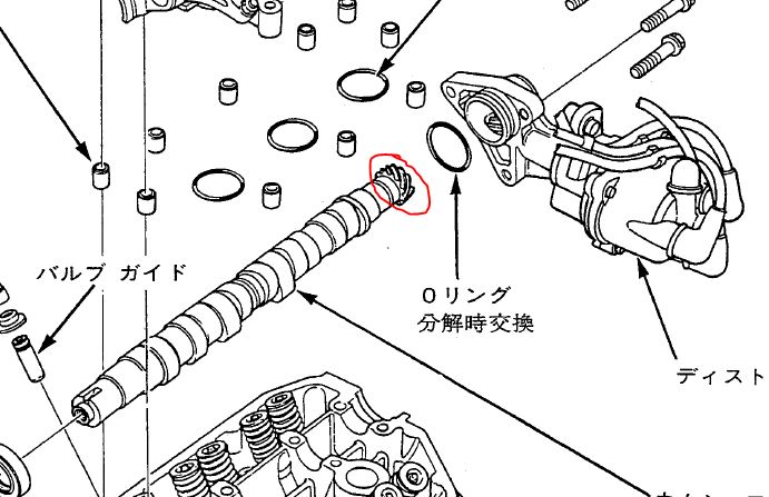

I wonder if you have a cracked drive gear on the end of the camshaft and it is moving about.
Why did you rebuild the engine originally? Seized distributor/snapped cam belt?
If you take the distributor off and the the distributor mount housing off you would be Abel to inspect that gear on the end of the camshaft.
I suspect it's moving and causing your varying timing.

The fact you seem to having varying timing e.g. one point running OK, then wont even start. I would certainly check the distributor drive gear.
Attachment 2483
This gear is just press fitted onto the camshaft, no keyway and If the distributor has seized in the past, the gear can crack and become miss aligned on the camshaft and even move at will.

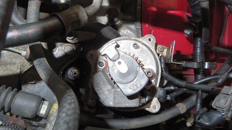

Recheck your static timing before removing the distributor, get to TDC No1 and see where the rotor is aligned.
Ok, so the little cam gear is very ok. I didn't open it up, really running out of time. My mechanic spoke to me and he said it was in great shape as he redid the head for me, replaced the valves, seals, springs, head gasket, timing belt and water pump.

Once again, i put the engine on TDC, Cam Sprocket is on the right mark and says UP. I even opened up the tappet cover recently to make sure the marks behind were also ok. Here i put a photo of the dizzy as the engine is on TDC.
Let me know your thoughts.

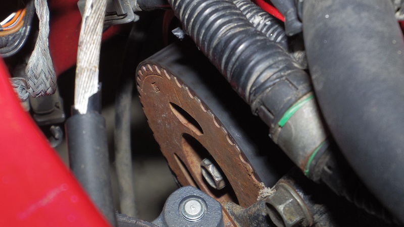

Attachment 2484Attachment 2485Attachment 2486
I never continued with the thread but got the car working again. I had to buy a used ecu from Japan, the repairs did to the original were a bit too late. The repaired ecu worked but with the distributor 2-3 teeth off in order to get the TDC mark with the timing light.
