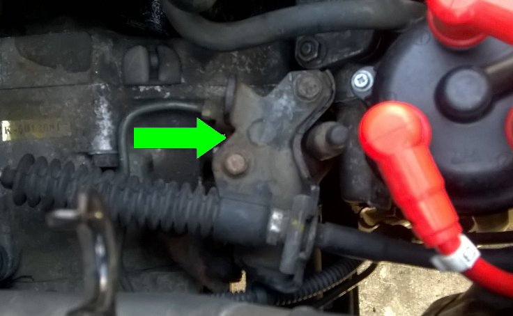

How do I access the slave cylinder if not dropping engine? Any help would be appreciated. Cheers
The clutch slave cylinder is hiding on top of the gearbox under the shift cable bracket, you would need to disconnect the cables and remove that bracket (2 bolts) to gain access to the slave cylinder.

Hi Steve which direction would I get to the slave cylinder from as my mechanic wants to cut the parcel shelf out and weld it back to get access. There must be an easier way than that surely?
Parcel shelf unbolts I just posted a pic here http://www.u-ukhbc.co.uk/vbb/showthr...4039-Fuel-pump
The slave cylinder is located here, under the gear-change cable bracket - two bolts at the top of the bracket.Attachment 2748
