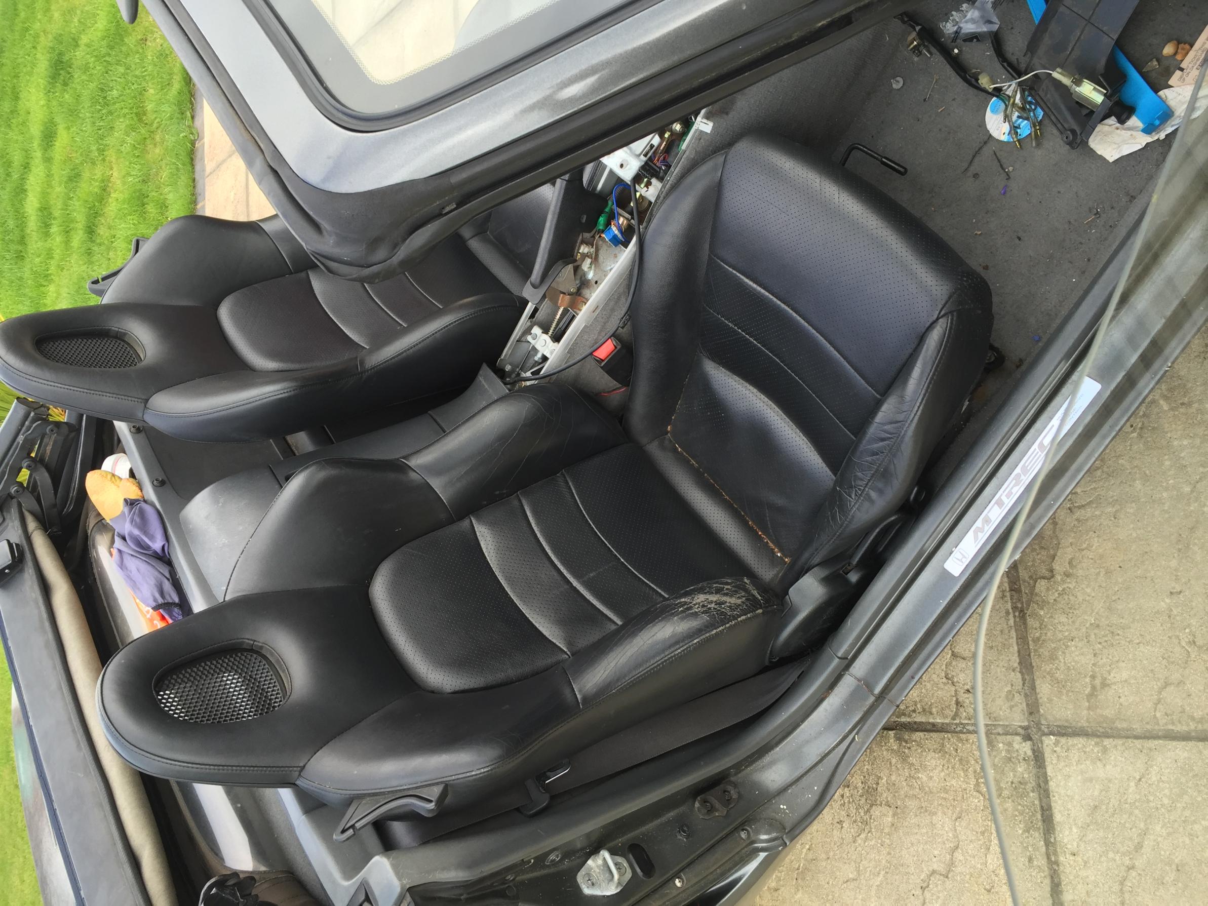

Well I have the seats and I'm butchering the runners etc to get them to fit but so far so good I'll post some pics soon. But it seems to be going ok on the drivers side. Seats are a bit tired but I'll clean the up properly once I've got them properly fitted
Pleased. :)

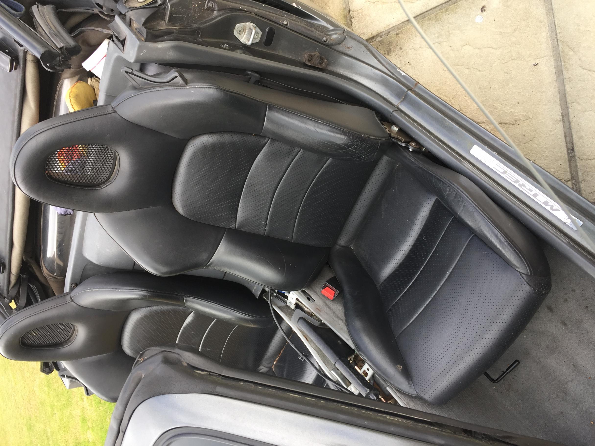

Ok drivers seat is in and looks great still got to clean it up but love the look of it. The hard part now begins. The passenger side is 2" narrower therefore fitting the huge S2000 seat will be a real challenge. Should be fun getting it to squeeze in but I'm confident it'll go. Lots of fab I think but we'll see.
What'd you have to do to the runners to get them to go in?
The runners on the S2000 seats? We took everything off. The only remaining part was the original sides as these keep the seat together. I then welded the Beat seat frame to the underside of the S2000 seat after cutting off any excess metal.

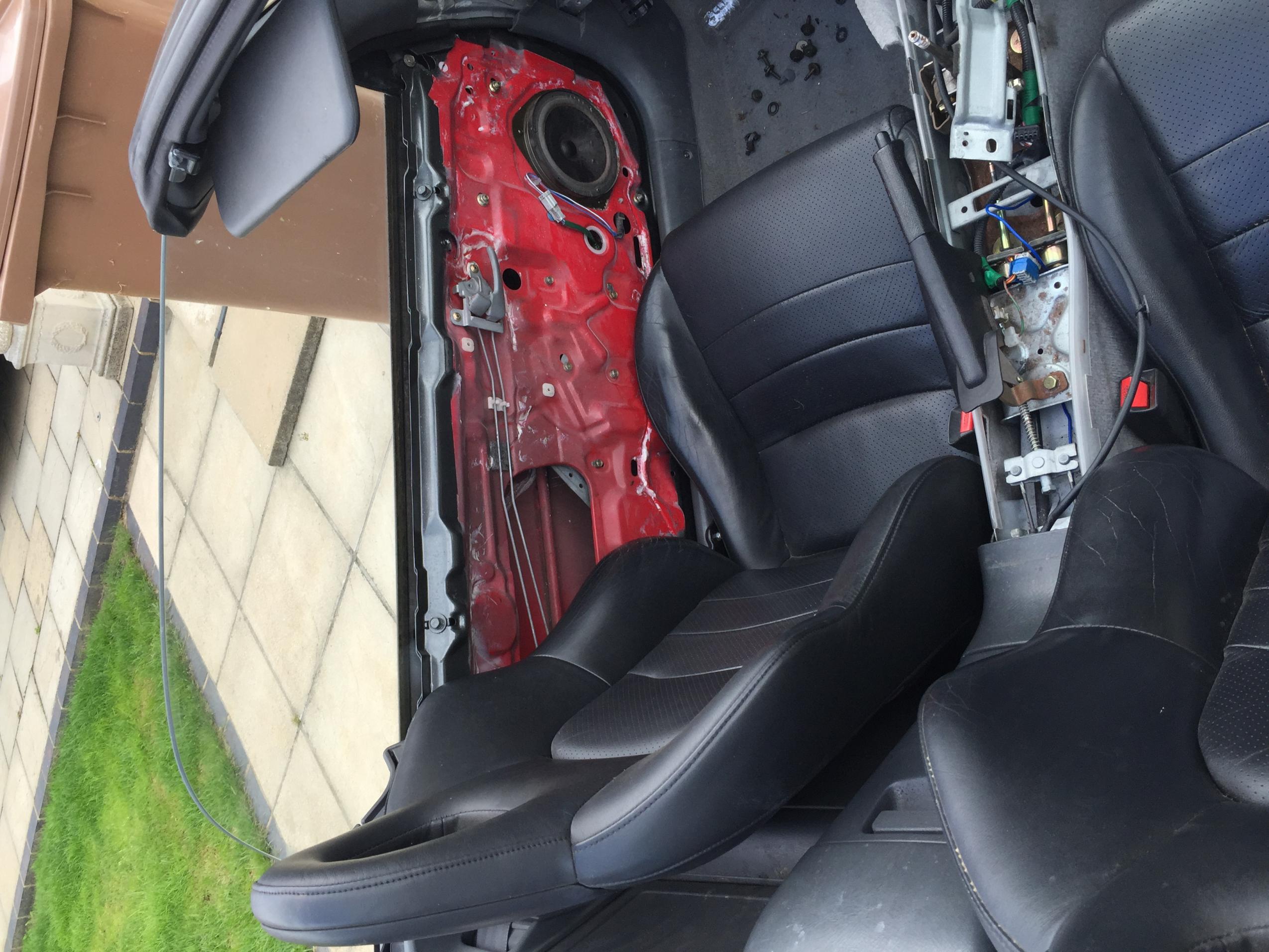

The drivers side was actually quite easy, the passenger side you have to be prepared to fix the seat back as space is so limited. it's incredibly tight! I have managed to get the seat adjustable forward and back but there is rubbing on the centre tunnel. I will take some pics this week end and show you how they look. overall I'm really pleased with them I just need to clean them up and then I can move on to more interior fun!!
Attachment 2608Attachment 2609Attachment 2610
As you can see it is very tight on the passenger side. The seat will be in contact with the door card but thems the breaks I guess.
