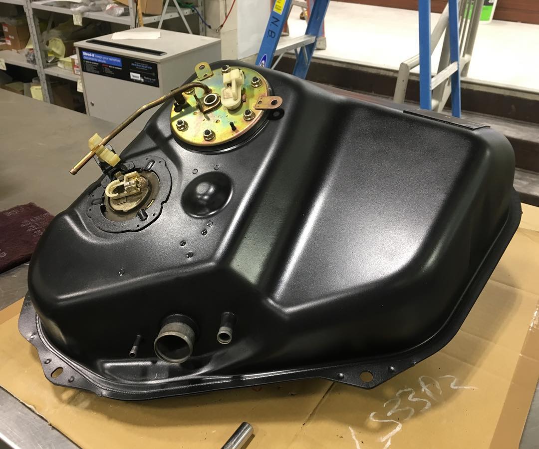

No, tank stays in. Remove parcel tray cover, remove pump cover bolts, disconnect wiring harness and hoses, pull up and out pump/sending unit.Attachment 2746
As I've got it apart today...
You just need to remove the drivers side parcel shelf (7 bolts) - no need to unbolt the seat belt, just extend it and rest the shelf on the roof.
Make sure you take off the fuel filler cap before taking off any fuel lines, to remove any pressure in the tank, or you'll get fuel spraying everywhere.
Attachment 2747
