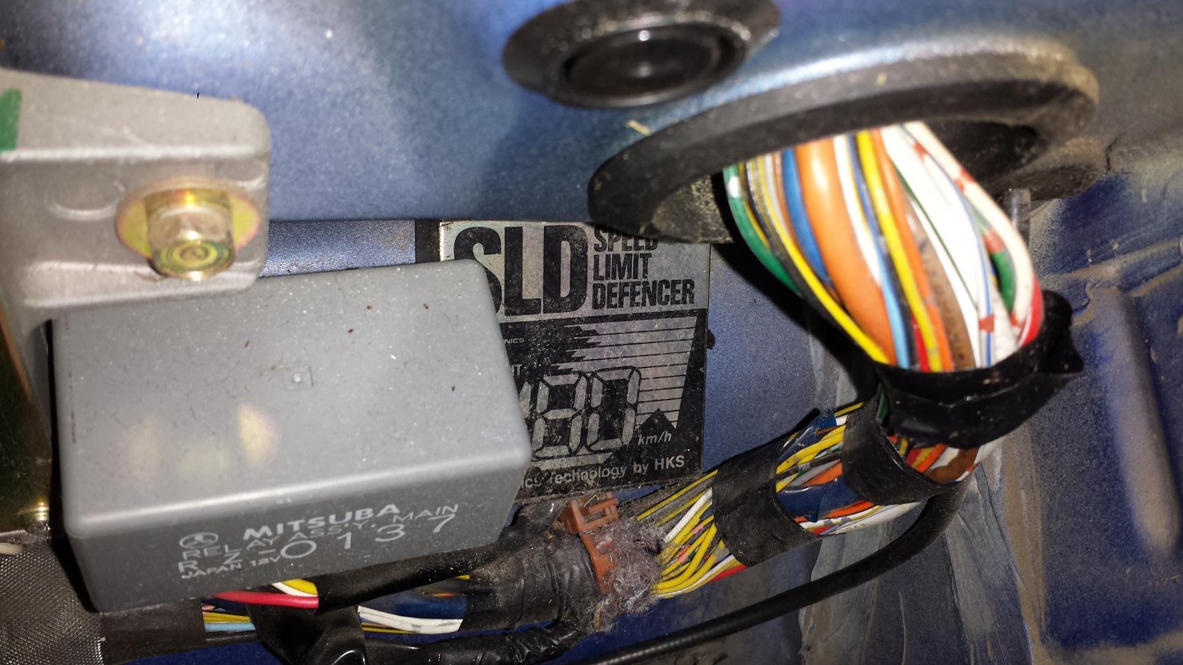

I was whipping my ecu out to do the caps and found ...Attachment 2405
I seem to remember these from years ago... Anyone got one?

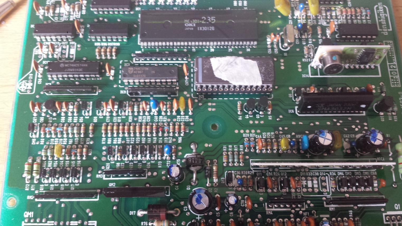

Attachment 2416
Chip fitted.. Wish me luck!
Finally got the ecu back in and all is well with the new chip. Rev limiter gone, can't comment on speed limiter as the sld is still fitted.
does it feel ant different? i'm debating getting funnels and chip or save for other bits
It does feel a bit more responsive especially in low to mid range and seems to rev more freely. It's a bit hard to say though as I'd not driven it for nearly a month!
