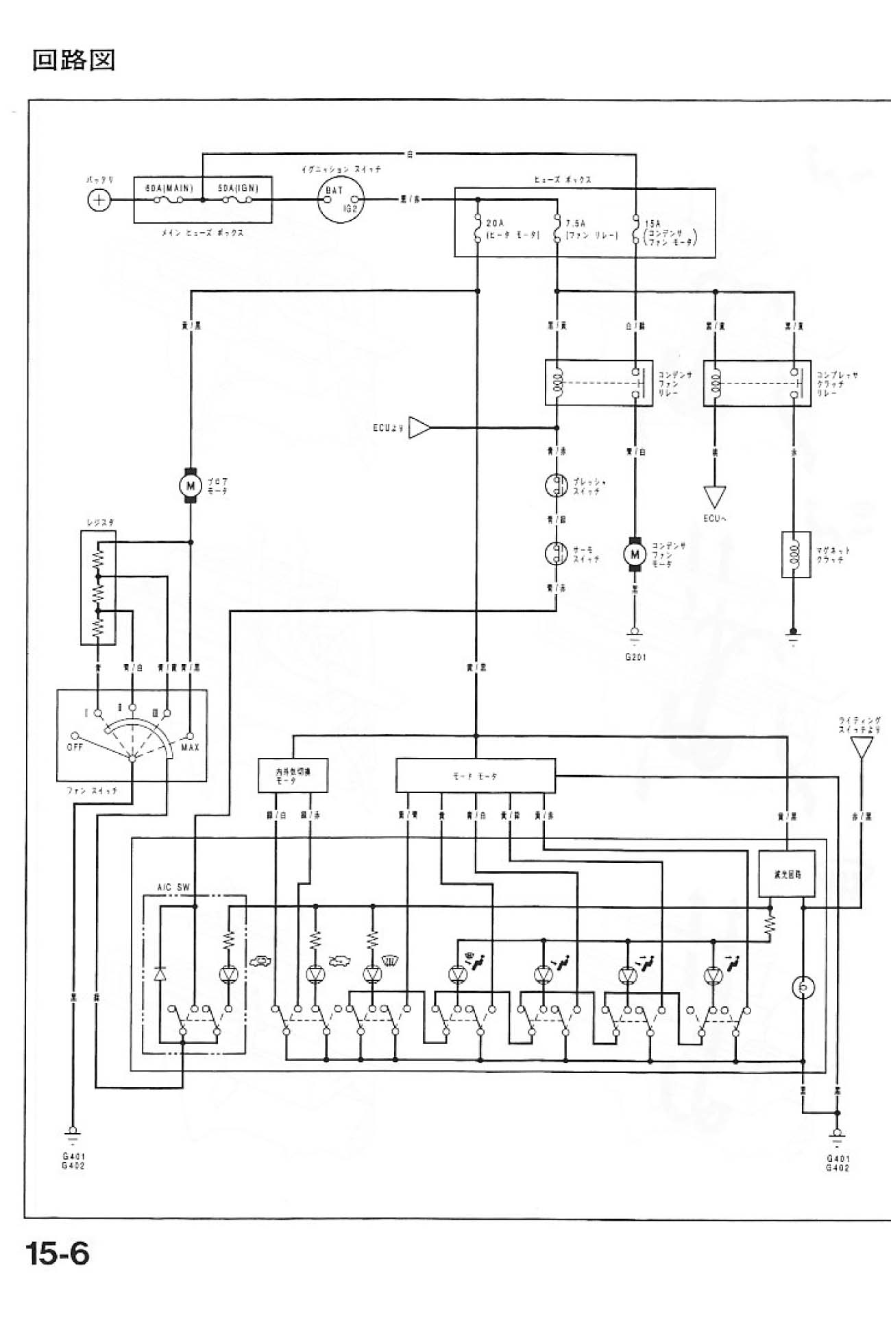

I've attached the translated wiring diagrams, with the most applicable being on page 6. I've also attached the heating system workshop manual which has a wiring diagram on page 15-6 which also shows the switches for the controls. I'm a bit confused, as the two diagrams don't really appear to be consistent, but maybe they show the same thing but from different perspectives. You can see the 7.5A fan relay fuse on both, and the AC system, but I can't quite figure it out.

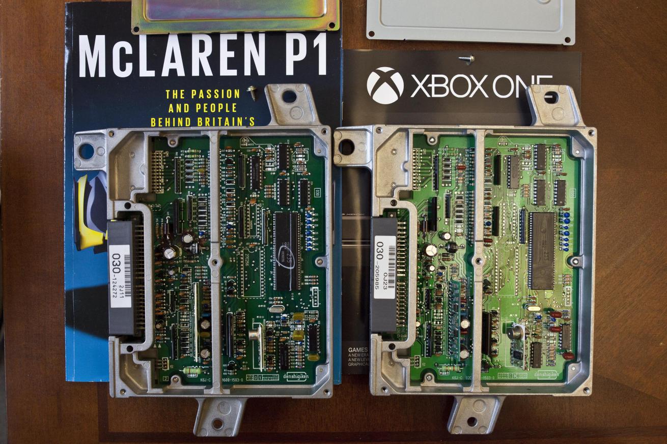

I wonder what to do with the old ECU - maybe I'll mount it on the wall... I've attached a photo comparing the old and new ones - there is quite a drastic difference in how much lighter both the case and the PCB is in colour, though I may prefer the green and gold tone of the old case. The car often ran fine with the old ECU in, once I figured out how to reset the ECU occasionally, but it did randomly suffer bad hair days. So if anyone wants to buy it at a heavy discount, please message me.
