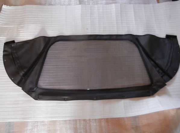

The rear screen doesn't seem to have all the outer material and zip - is it an aftermarket one?
Also - if you're taking your air-con off would you be looking to sell the bits off? There are some aircon bits I need (things like the expansion valve).
stuei
got a picture of how it should look?
more than welcome to the bits i've taken off, some of it didn't survive like the radiator and some of the hoses! drop me a PM
Rear screen and surround looks like this...
Attachment 2693
hmmmm, not sure, i've just unzipped mine, maybe it's aftermarket
