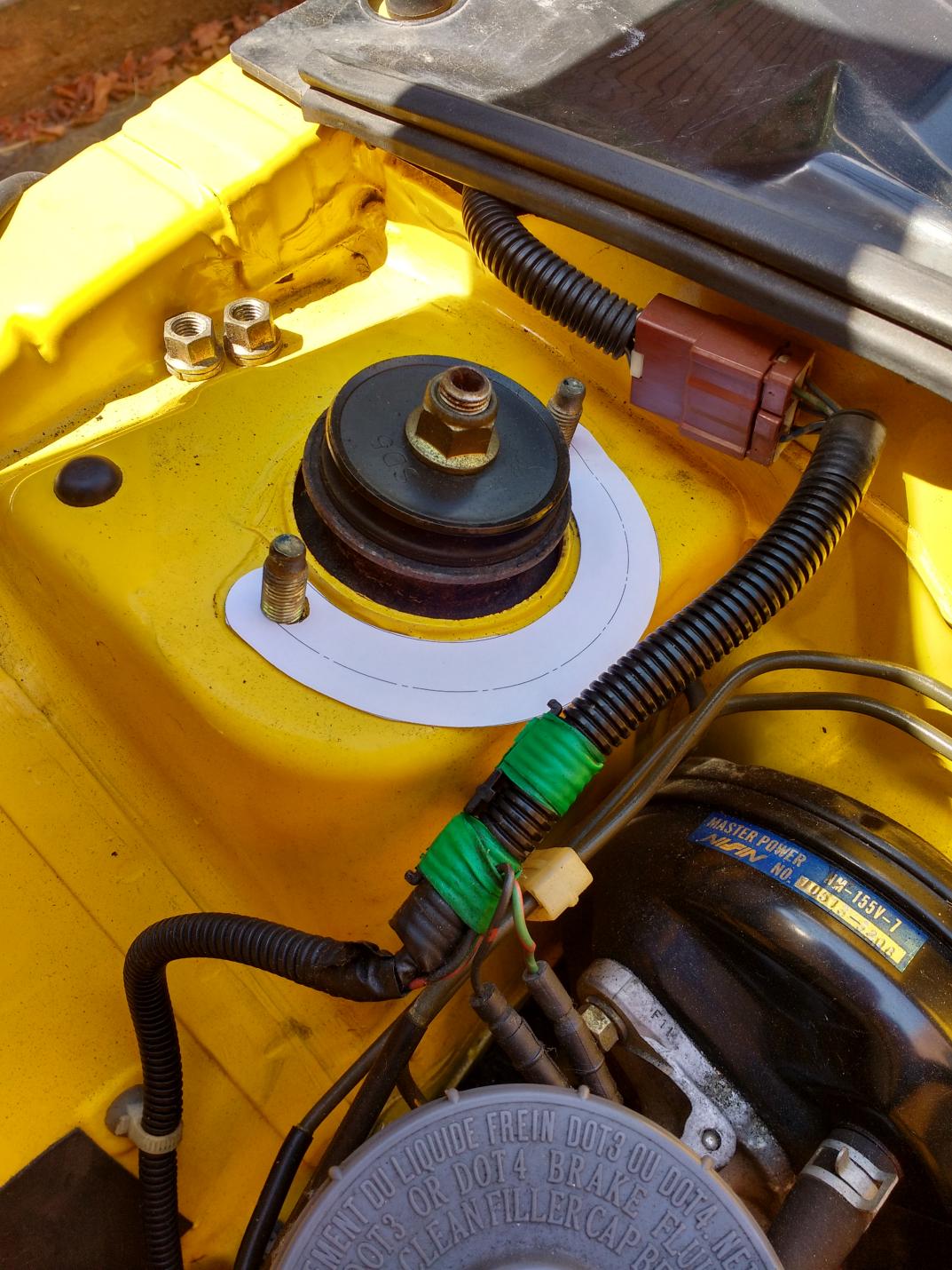

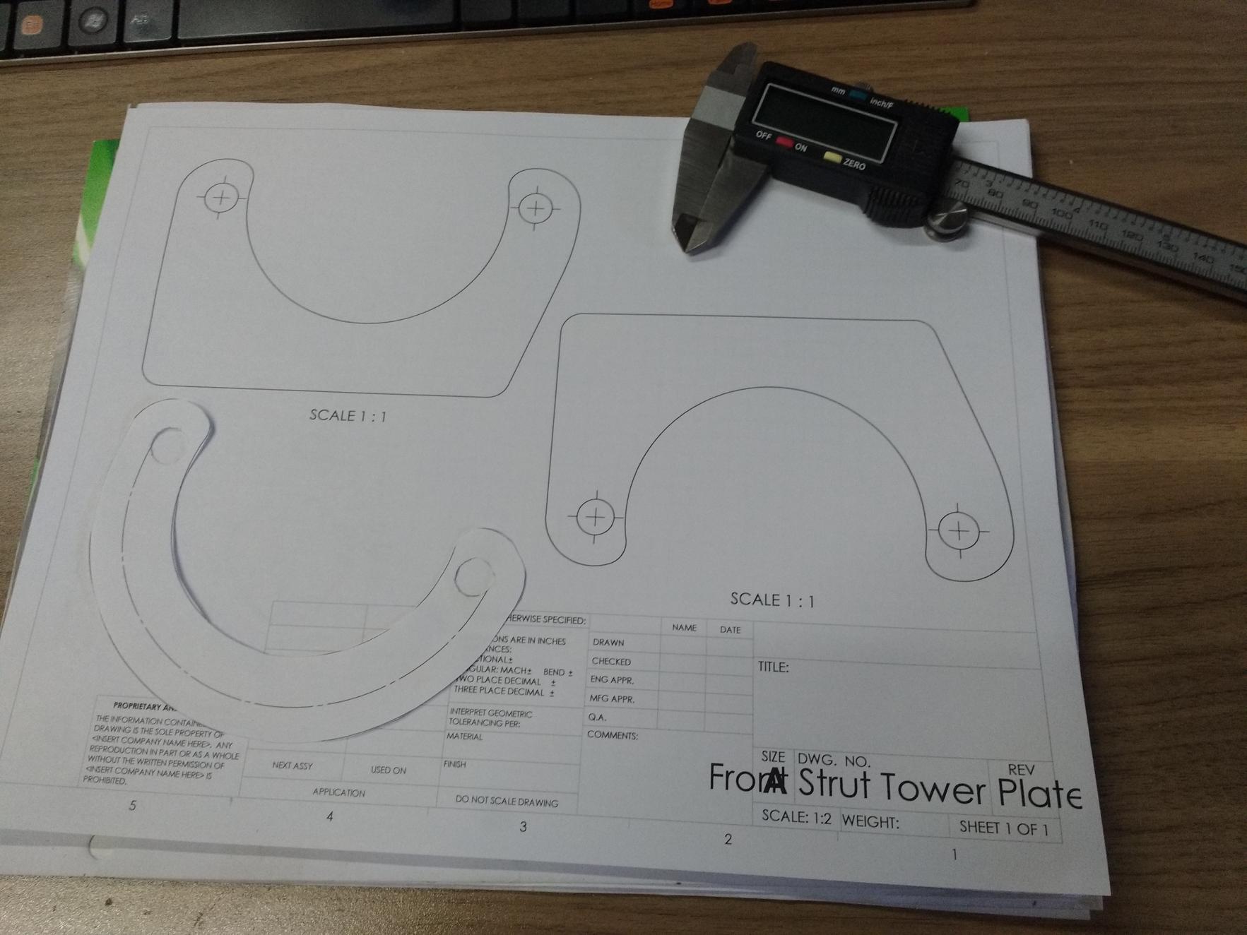

First off I took a variety of measurements and input them into Solidworks to create a paper test template.
Attachment 2628
Then after I knew the dimensions were decently accurate I refined the shape of the base plate to accommodate the upright support structure that would bolt to the cross bar.
Attachment 2629

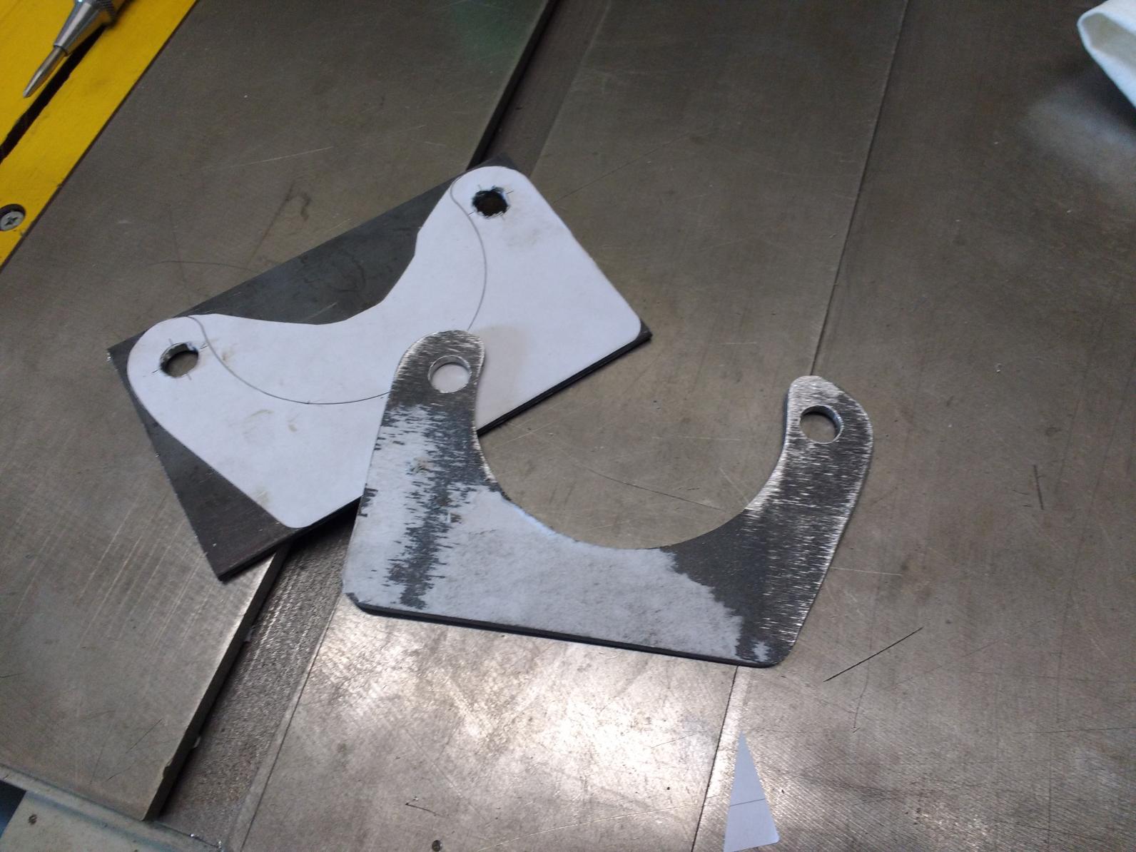

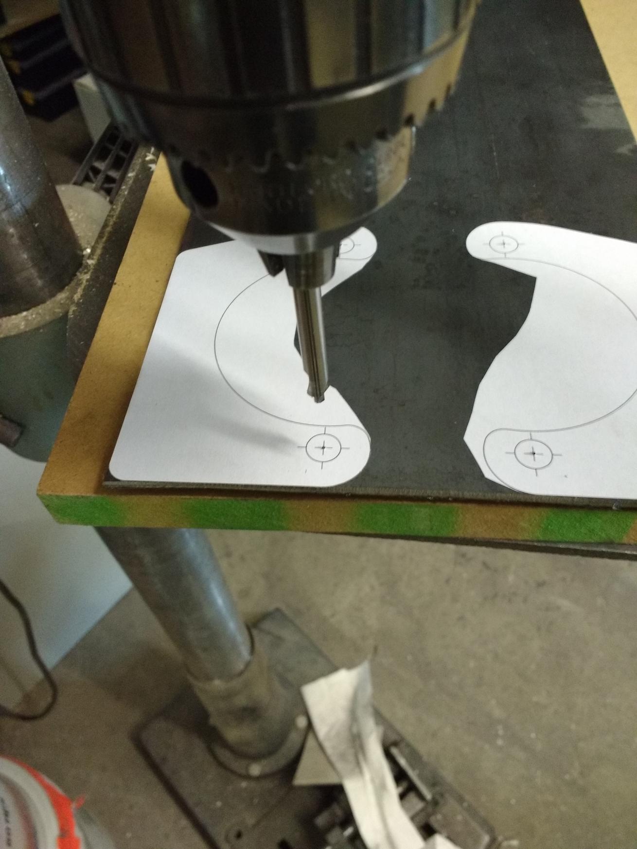

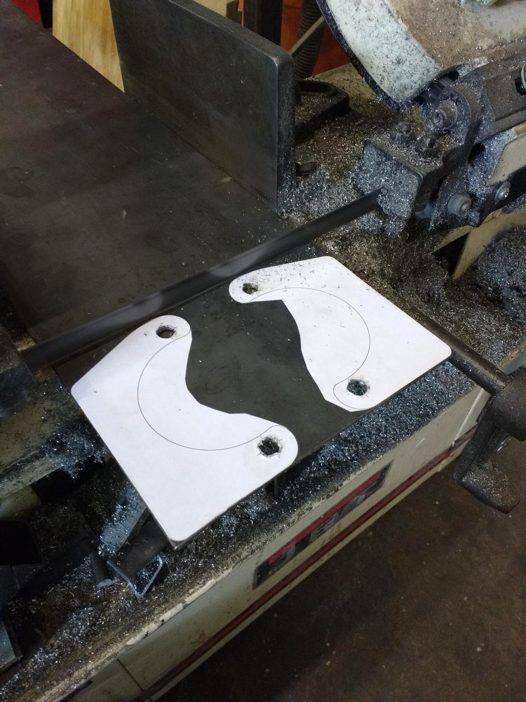

I then took the new templates and spray mounted them to a sheet of .12" steel (3mm). I center punched the hole locations, scored the cut lines (just in case the paper came off during cutting) and began drilling.
Attachment 2630
Once completely drilled I parted the pieces off from the larger sheet and separated them from each other to better maneuver them while cutting out the final shape.

I then went to the vertical bandsaw and roughly cut out the shapes before taking them to the bench grinder and lastly a spindle sander for final shaping. This is after the first one was done.
Attachment 2632
