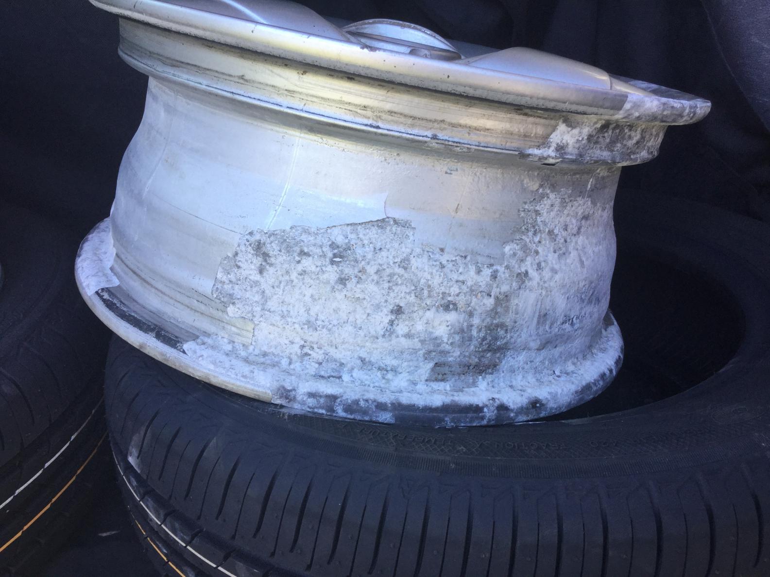

I went to take the barn find beat wheels to swap to new tires today, backs are ok but the fronts looked like this with the tyres removed! Anyone got any original steel wheels for sale??Attachment 2715

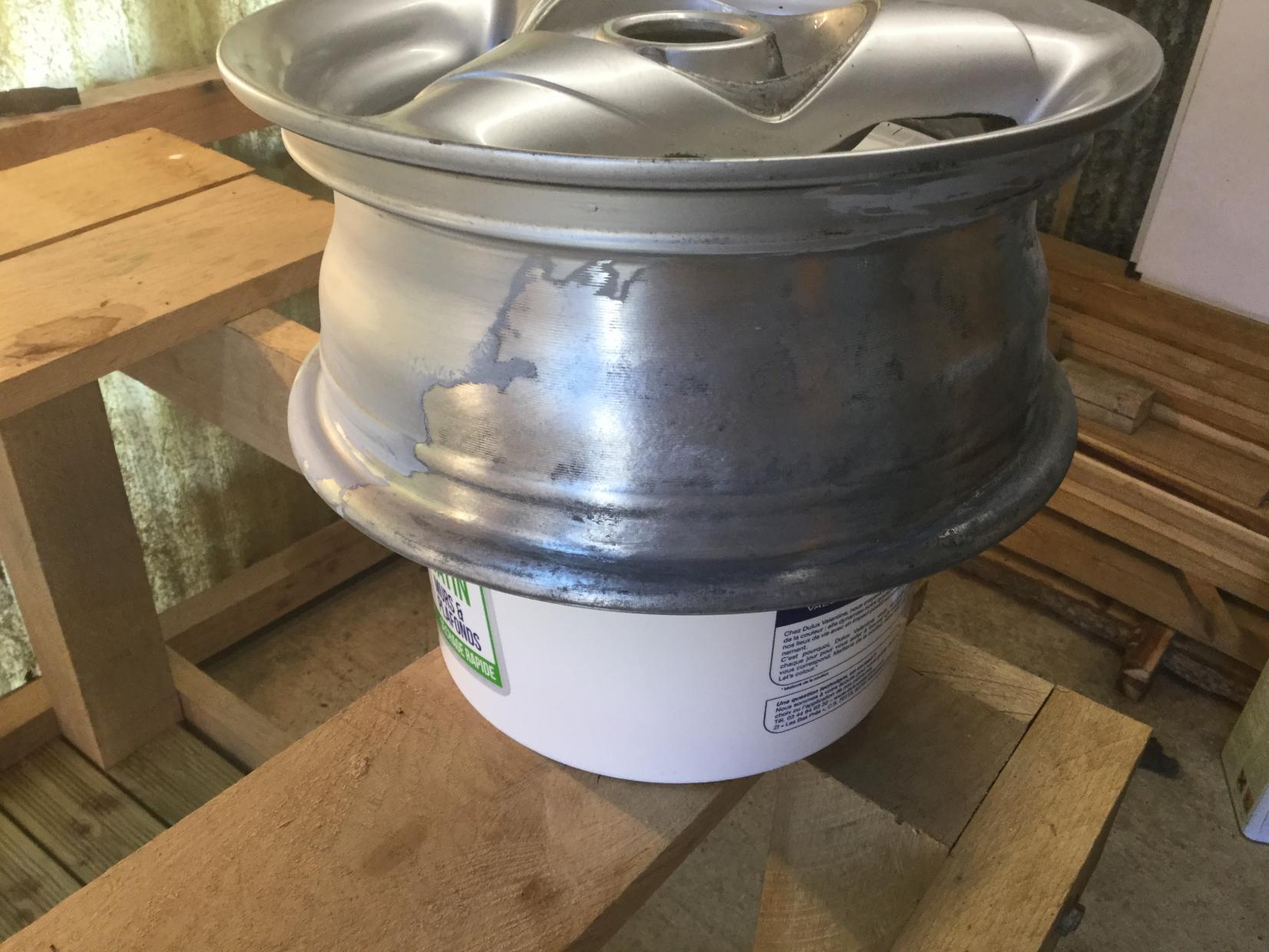

Panic over! Got the dendix brush on the grinder, and it came back okAttachment 2716

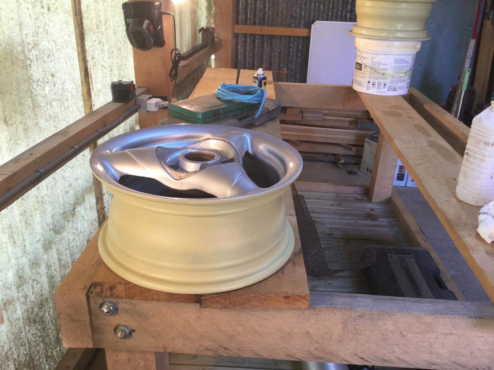

Bit of etch primer, and will get them painted tomorrow.Attachment 2717
