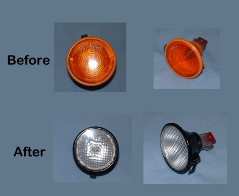

    Have you noticed how the fashion now on cars is to have all clear lamps.
    Well I saw some info on a Japanese website about a Beat's Orange Side Repeaters.
    And Well here is the result!!
    Just need to get some orange bulbs for in the lamps.

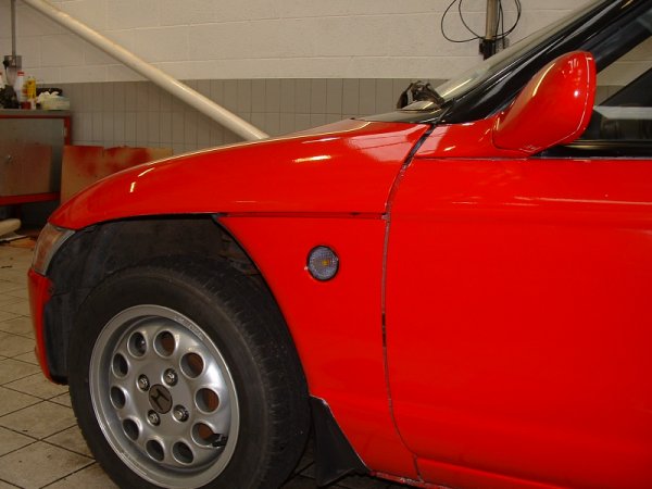

    hey presto!!
    The finished article

    Looks great, but that pic highlights the only thing i dont like about the beats styling. those wheel arches (well, not so much an arch more of a meeting of panels!)
    Any comments?

    Steve,
    Is there any chance of you sending me 2 clear lenses cut to the correct size to put in my side repeaters.
    Or could you tell me where to get the clear plastic from, cut to the correct size.
    I've looked everywhere and I can't find anything suitable.
    Did you paint the bulbs orange or were they bought? If so, where did you buy them from?
    Thanks,
    Dion
    The clear lenses are made from a Honda CRV reverse light lense, I had been looking around trying to find some thing suitable, all i could find was clear arylic, but it really needed to be textured in some way to spread the light.
    It then just so happened i had to replace a CRV reverse lamp cluster as the lower part, which is a red reflector was cracked, so a bit of work with the dremel and hey presto two round discs of textured plastic.
    The orange bulbs i bought from Halfords, they are listed as 501A bulbs, they fit Honda Accord side repeaters (which are clear).
    Some one told me you could get silvered bulbs which were orange when lit, but im not sure where sells them.
    i sprayed the reflector with some chrome coloured paint and the surround with satin black. then glued the plastic lenses in with epoxy glue. i also sprayed them with light tint spray, but at the mo am not 100% sure if that looks right or not.
    HTH
