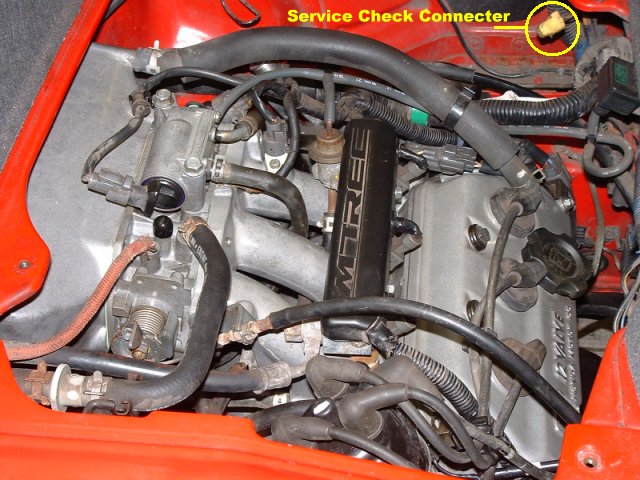

    This is the link to the instructions
    http://www.u-ukhbc.co.uk/troubleshooting.htm
    and here is the connector

    Please can you tell me how to obtain entry into the engine bay (as in the picture). Ive had the car for just over a year now and think it is time to give it some TLC (well over due i guess).
    Many thanks.
    Ipswich
    985
    Hi,
    Firstly, Shame on you...lol Fancy not knowing this... (only joking... )
    Access to the engine is actually VERY easy.
    To do it properly, you remove all the screws from arount the bottom of the roof, fold it up and onto the main part, remove the rear shelf covering and you should see a pannel with 4 bolts. Undo the bolts and the engine is under there.
    ALTERNATIVE METHOD.
    Unzip the rear window and fold it outwards onto the boot lid, remove the rear shelf covering, then undo the 4 bolts on the pannel. Then CAREFULLY remove the pannel minding the rear window and the engine will be in front of you.
    Hope this helps
    Ady.
