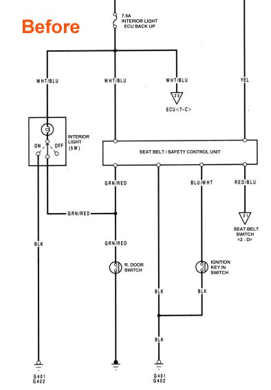

    its quite easy to do by adding in a relay.
    here is the circuit before modifying.

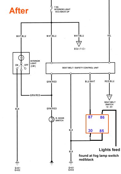

    Originally posted by Steve_M
    And after, how you need to modify it.
    you can find the wires you need at the ignition switch.
    and the light switch feed at the plug for front fog lamps.
    HTH

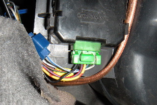

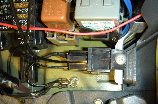

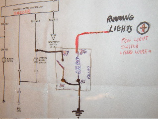

    Sorry to resurrect, but I wanted buzzer on if lights left on, *and/or* if key is left in the ignition. Very forgetful. Three very easy hookups without having to remove ignition cover.
ID:	1828   Click image for larger version.
ID:	1829   Click image for larger version.
