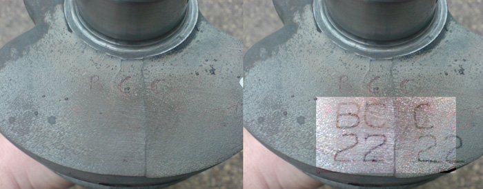

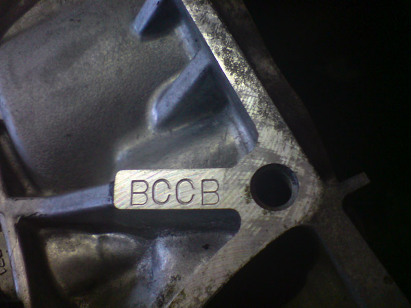

    this had us stumped for ages with mine - no colour codes on any of the bearings and we couldnt make out the text at all until we took the crank out in the sun.
    heres a couple of pics to show you what you're looking for (without the biro pen scribbles!) - if its anything like ours it'll probably be VERY VERY faint and you'll need to tilt it round in the light to see - my camera couldnt pic it up well.
    i presume you've seen the section of the manual that describes how to check the sizes? i think beardo has it on his page if not: http://affordableperformance.org/doc...g_markings.pdf
    hope this helps!

    Use the info I put together to collect the codes from the crank/block and rods.
    Heres a link to it on Beardo's site
    Then use the specific page in the Shop manual to work out which bearings you need.

    The markings on the crank are very faint, they are sort of laser etched on to the front web. Some time makeing the survace wet with some WD40 and using the angle of the light you can read them.

    My mechanic has managed to read the codes from the face of the crankshaft.
    OK, so I've got "CCBC" on the block, "222" on the rods, and "CDC 3222" on the crankshaft.
    If I'm reading it correctly, that gives us main bearing sizes: brown, green, yellow, green (respectively).
