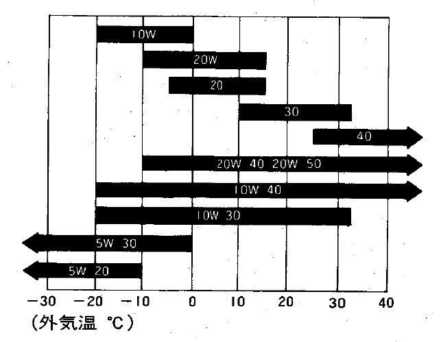

    So there is no problem to use 10w40 in stead off 10w30?
    You will struggle to find any range of 10W 30 oil in the UK, its not a grade that is normally used, Don't forget Japan does have a completely differant climate to the UK.
    As you can see from the chart below 10W 40 covers the same range as 10W30.

    Thanks!
    that was all i need to know
