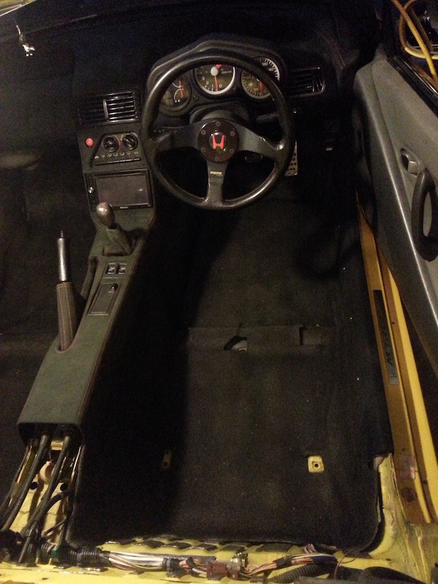

    Here's a pic of my setup (excuse the missing seats and panels)
    It uses a special center console to allow double-din headunits
    standard 1991-1995 honda radio adapter works for wiring aftermarket headunits
