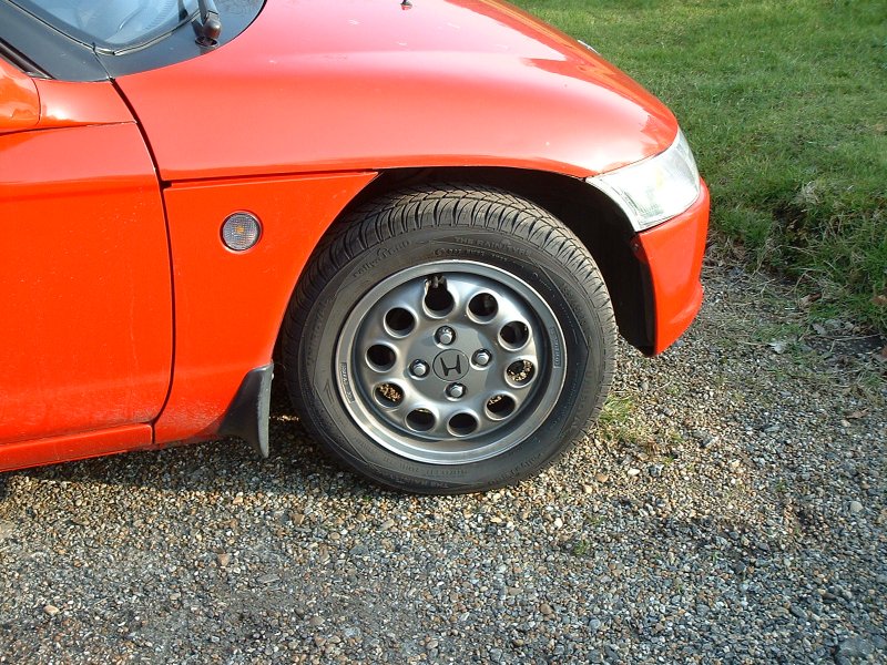

    I re-finished my wheels myself.
    Paint stripper to strip the laquear off the outer rim, then using a combination of a file (for the kerbed bits), wet and dry, wire wool and finally Autosol metal polish.
    Then found an aerosol colour that was as closest match to the original colour (e.g. matches the centre cap) I think it was a Ford Storm titanium, I sprayed the centre with that and then laquered the whole wheel and baked in the kitchen oven to dry nice and hard.
    The result . . . Click image for larger version.

    Thanks Steve. I used to re-do my Alfa wheels (the famous BMW Polaris Silver) but I'm not about to do it myself now (haven't got a large enough oven for one thing). It's good to know that paint stripper would do the trick. I'm looking around for local shops that can do it.
