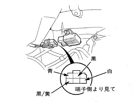

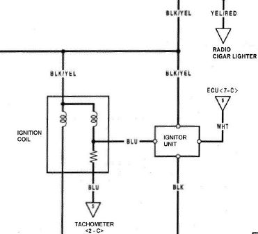

    Ignitor diagnosis
    As per the wiring diagram, the ignition ignitor has 4 wires.
    Blk = Earth
    Blk/Yel = Ignition live from ign switch (~12 volts)
    Blue = coil trigger
    Wht = ECU connection (ECU trigger)
    Complete wiring diagram here

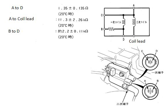

    Coil resistances

    Jun 2014
    39

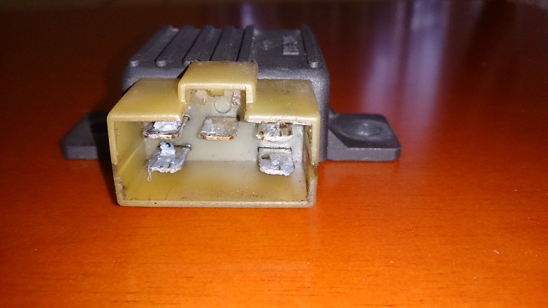

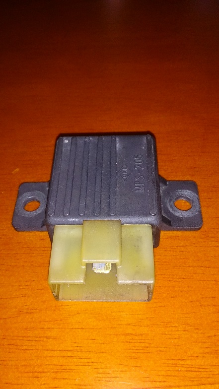

    Thank you Steve, i'm not near to the car atm to check the wire arrangement but in the attached photos is my ignition module with five pins. Your diagram only shows four. Is this a different setup?
ID:	2453   Click image for larger version.
    The connector is actually a 6 pin connector, but only has 4 wires.

    Its pretty hilarious, space for a sixth terminal but only five on the unit,of which the car uses four. Was going to attempt the Toyota ICM rewire and install but found this so i'm taking the chance.

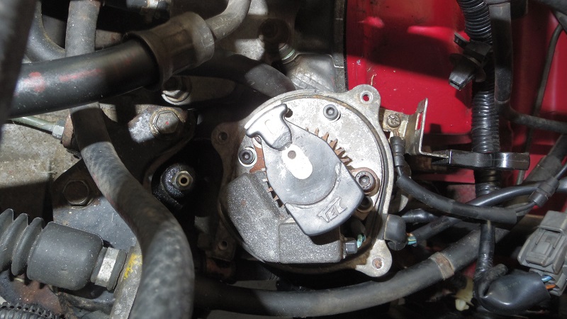

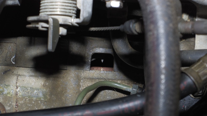

ID:	2478New coil and ICM did not resolve the issue. Car is home now, so starting over all the troubleshooting and i think the timing may be off. Please see attached photos.

    Hey Steve, i got the dizzy from Gavin, local post is a joke. Tried to follow the image for setting the dizzy timing, used the grub screw and slot at the bottom of the dizzy to align it with T mark when inserting it. Started after spending quite some time turning over the engine. Used a timing light and got the mark as best as i could, but this pushed the dizzy all the way to extreme of the adjustment bolt.
    Still backfires a bit, and sometimes if i revv alot over 5k RPM, it just dies down.
    Is my timing off still? Should i also check the fuel pressure regulator?
    Please take a look at the videos and let me know your thoughts.
    https://www.youtube.com/watch?v=duA1...ature=youtu.be
    https://www.youtube.com/watch?v=GifNVhScPB4
    It sounds to me as if the static timing is incorrect.
    I don't like the sound of the statement "I got the mark as best as i could" that doesn't sound OK
    What mark as best as could? What is static position of distributor when engine is on TDC?

    Hey Steve,
    I got the red mark on the flywheel with the timing light, I admit though that it did seem to be a bit erratic with regards to the timing light where the red mark moved a few millimeters. That is what i meant by close enough.
    When the engine was warm that day, it could be started very easily every time I did. When i tried the following day, nowhere close to starting.

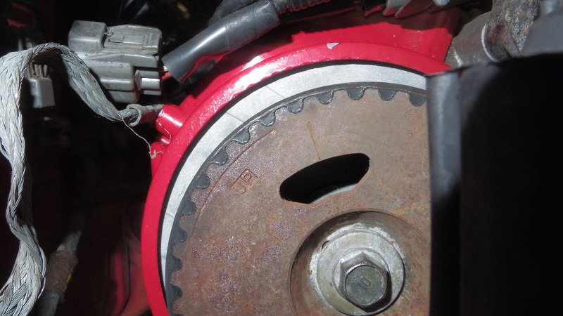

    I rechecked the timing again, white T mark when the cam pulley is up T marks on the back of the cam pulley line up with the head. Cylinder is all the way up and rocker arms on intake and exhaust are able to shake which means the valves are closed.
    I did two methods of setting the dizzy, the one that worked was lining up the grub screw with the mark at the bottom(the other was lining he centre of the rotor cap with the mark at the top) and letting it rotate as it should when fully inserted. Rotor lines up with the number one post on the dizzy cap. Not sure exactly what position it should be in relation to the no. 1 post(leading edge, centre or trailing edge). Or if it should line up with a mark when inserted.

  20. #20
    Jun 2014
    39
    Ok, so the little cam gear is very ok. I didn't open it up, really running out of time. My mechanic spoke to me and he said it was in great shape as he redid the head for me, replaced the valves, seals, springs, head gasket, timing belt and water pump.
    The dizzy didn't fail to cause the engine to break, instead it was a defective timing belt that burst and well broke the engine all those years ago.

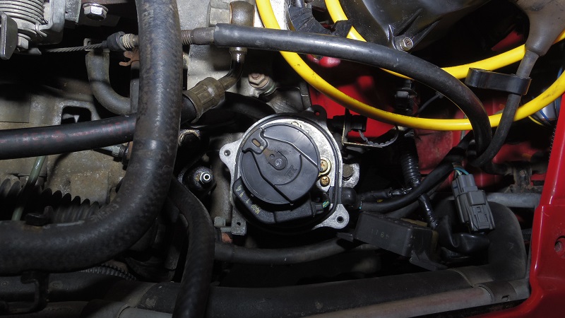

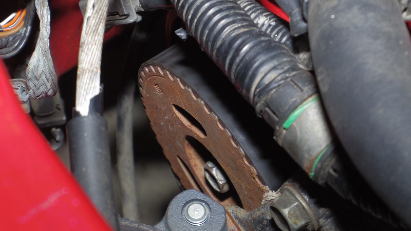

    Once again, i put the engine on TDC, Cam Sprocket is on the right mark and says UP. I even opened up the tappet cover recently to make sure the marks behind were also ok. Here i put a photo of the dizzy as the engine is on TDC.
    Let me know your thoughts.
