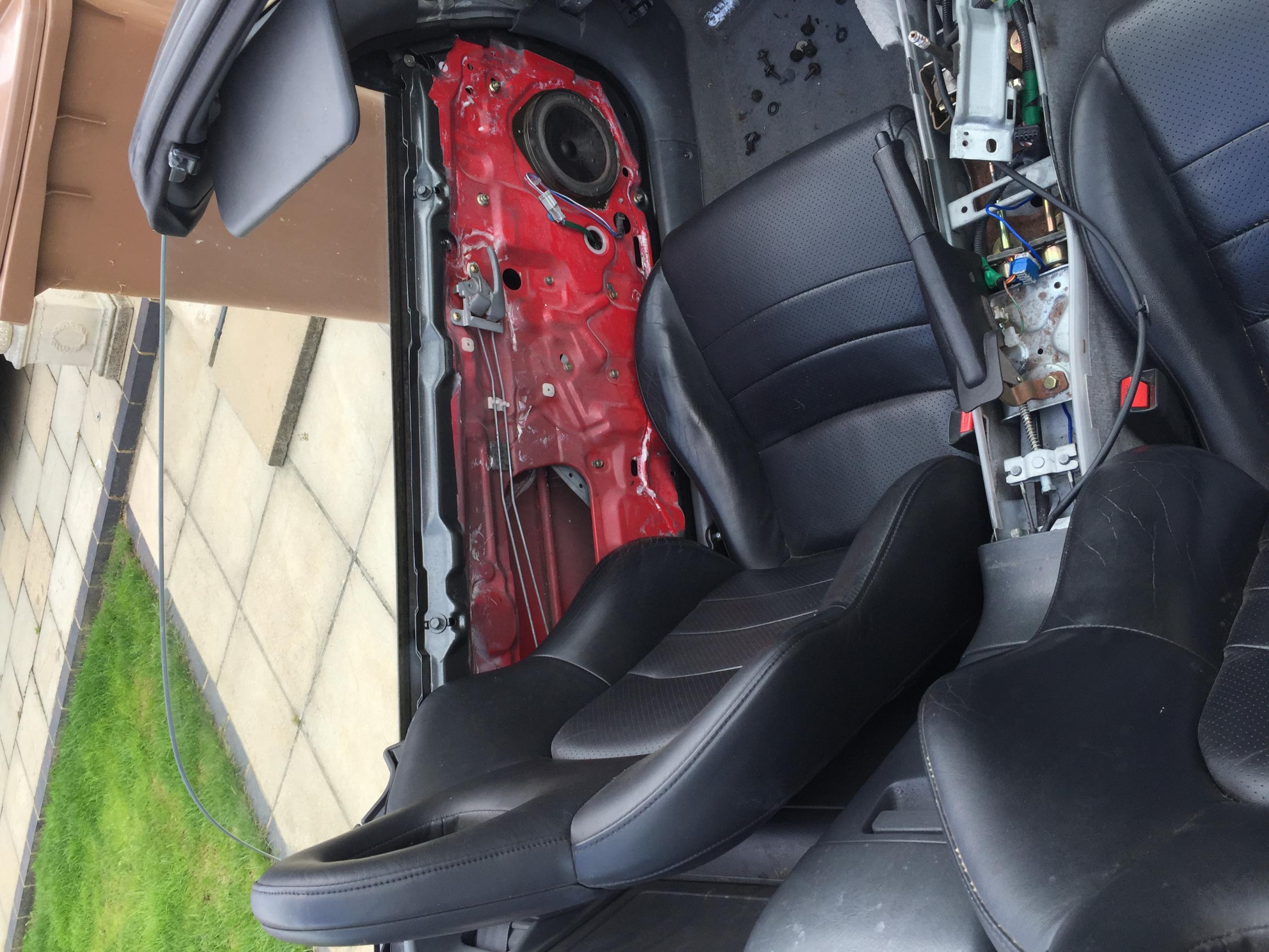

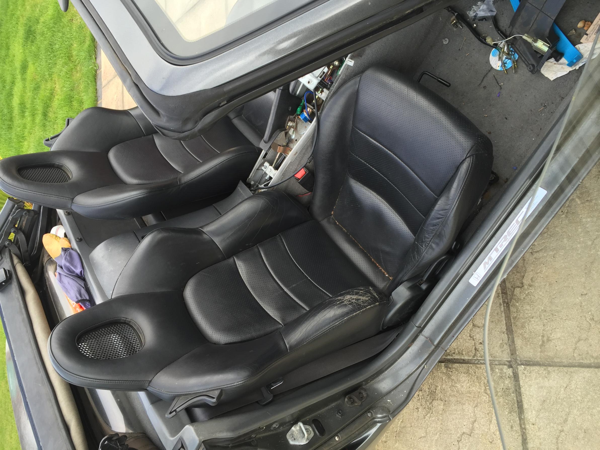

  18. #18
    Jan 2015
    48
ID:	2608Click image for larger version.
ID:	2609Click image for larger version.
    As you can see it is very tight on the passenger side. The seat will be in contact with the door card but thems the breaks I guess.

    Aug 2015
    Tohoku, Japan
    144
    Looking good! Would you have happened to have taken some pictures of the process? I'd love to see what you did.
