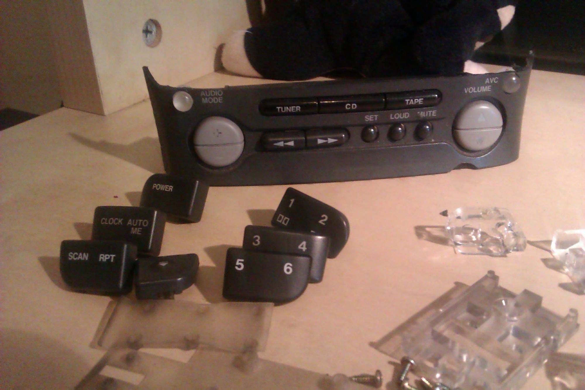

    common issue i'm afraid.
    just looked in my box of leftovers from the unit i butchered to fit my Fusion radio and you can't even use a 5-6 button upside down as they are different sizes as the unit tapers.
    assuming the small plastic stalk at back of button has broken?

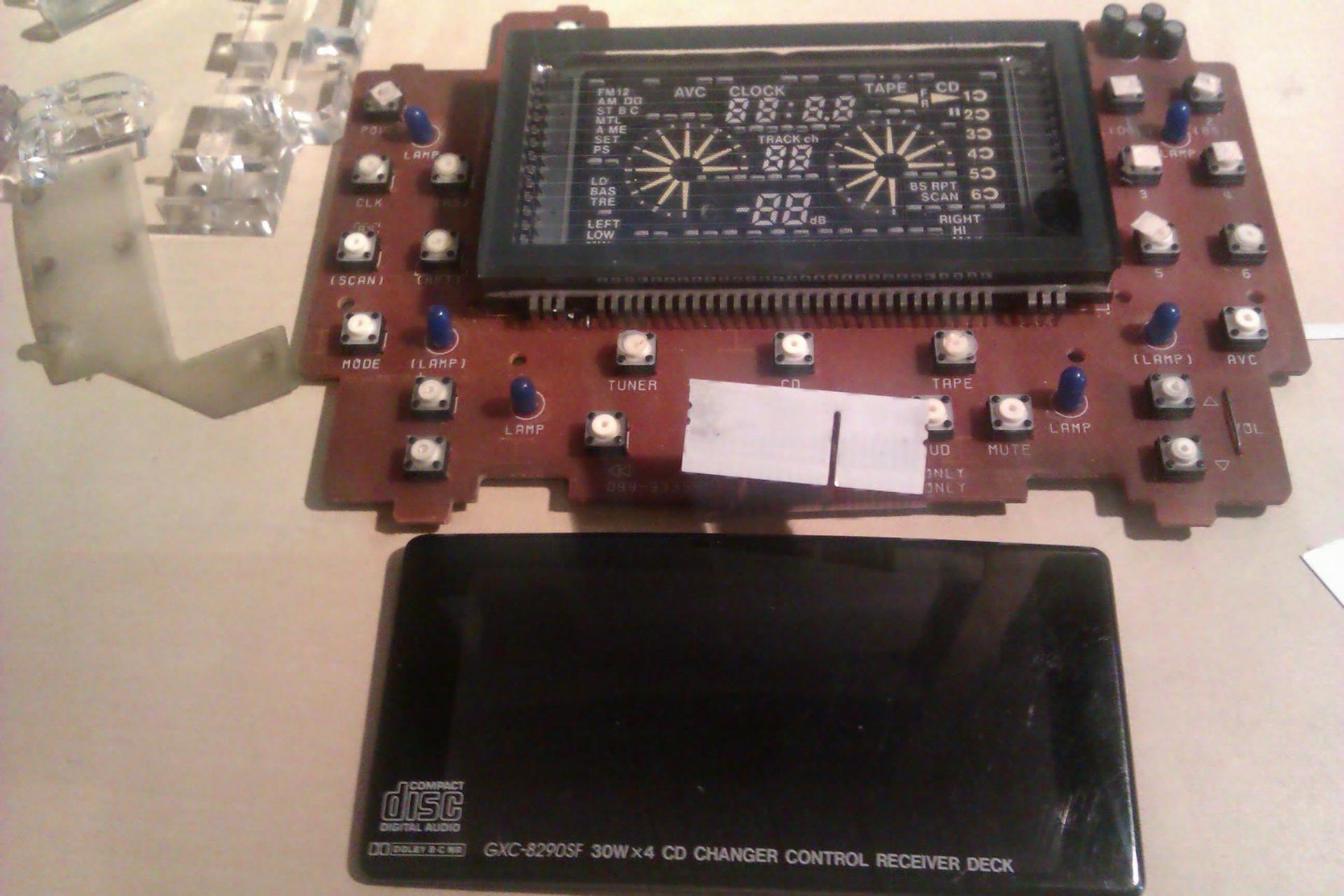

    behind the Grey cover there are clear plastic pieces to transmit light to buttons, then a gel covering over the buttons but with holes so the plastic stalks go directly onto the micro switches.
    i've got a pic somewhere of the PCB, i'll try and upload later for future reference
    re: the other post about 3D printing, it looks as though the buttons are clear plastic then coated Grey and the letters/numbers etched back out

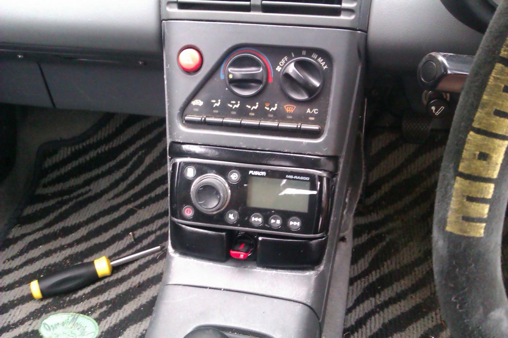

    Oct 2006
    Pye Green/72800 France
    584
    /\ what mine looks like now

    just a little....
    stripped out all the wiring, dash speakers and subwoofer and replaced doors with components, 2 small & tweeter in each dash pod replaced, Amp behind the passenger seat and HU with a Fusion Marine unit.
    all the info on mine and a few others is on here somewhere, mainly under the sounds sub-forum i think?

    Well the unthinkable happened, got the unit out, as carefully taking off the front face to reveal the buttons, I dropped the screen and it pulled the ribbon from the circuit board. I'm so cross with myself. Has anyone successfully re soldered the ribbon on. Are there any screen modules out there to be had?

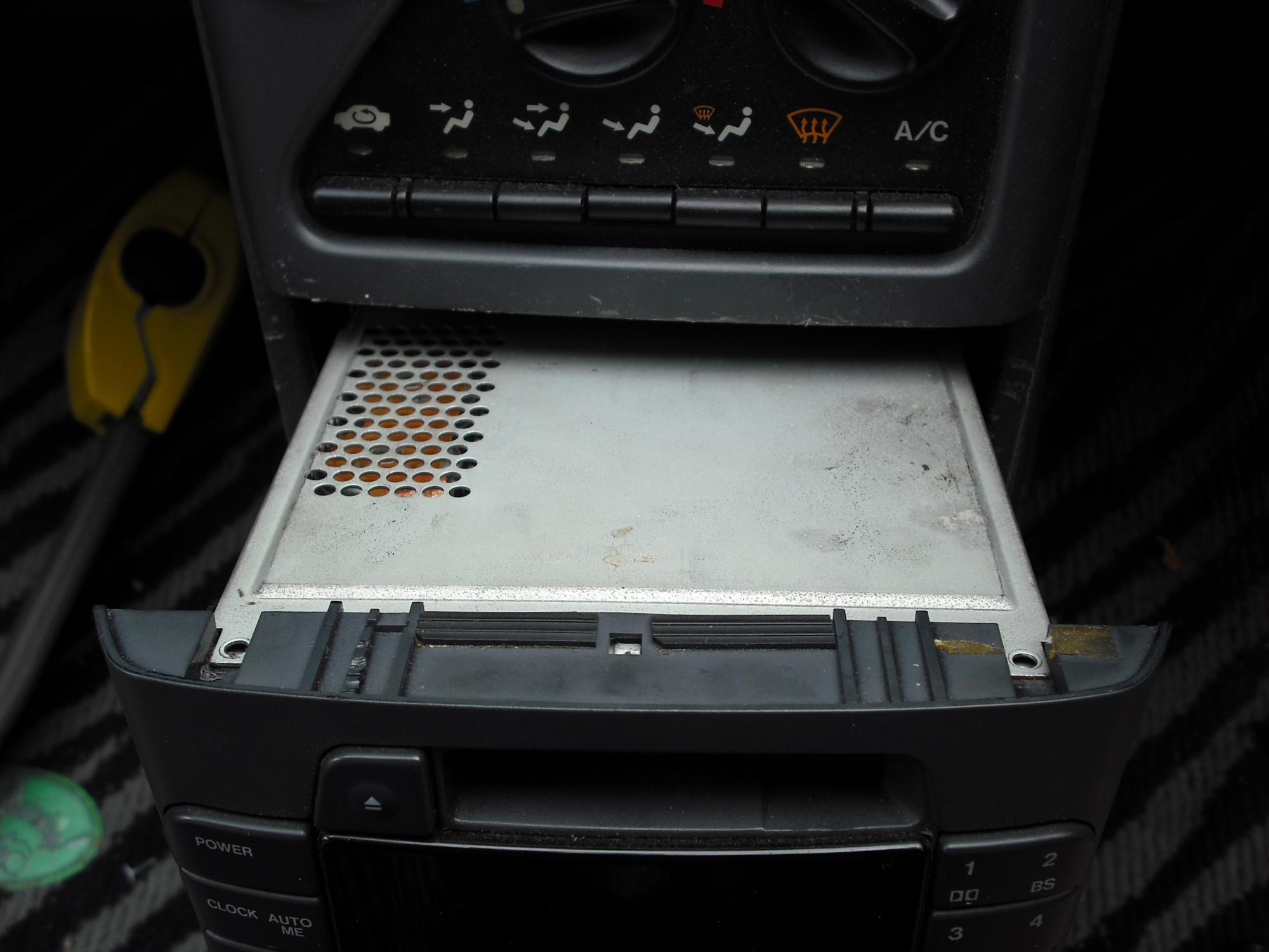

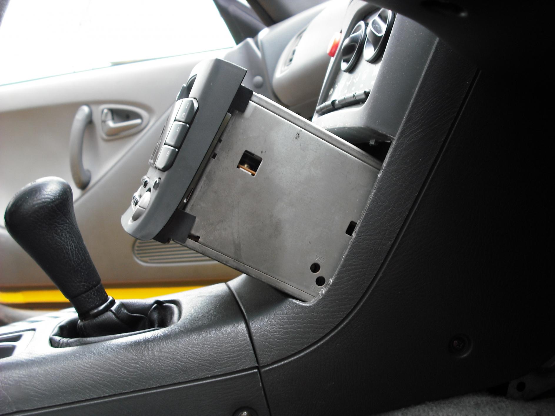

  14. #14
    Oct 2006
    584
ID:	2719Click image for larger version.
ID:	2720Click image for larger version.
ID:	2721Click image for larger version.
    cage held in by the 2 screws/bolts just level with the plastic trim
    usually not a lot of slack on cables as you pull cage out
    2 screws top and bottom hold the fascia on
