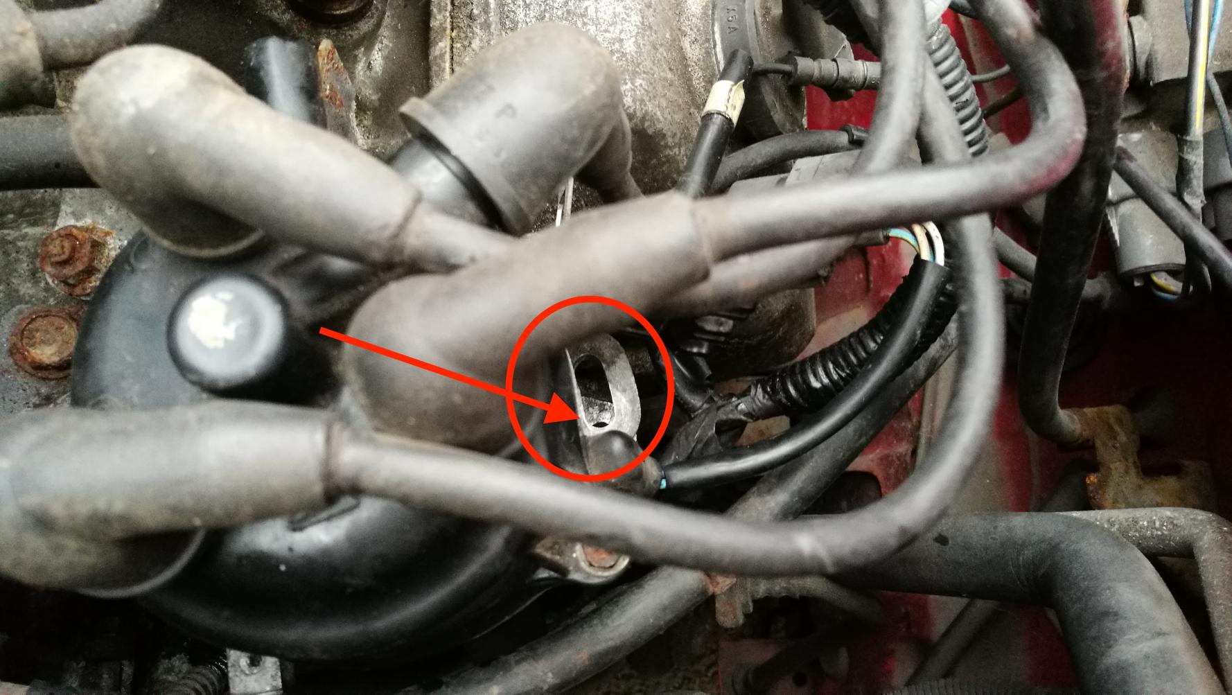

    Okay, managed to find TDC by dropping one wheel and rotating the other...my arms weren't long enough to look through the hole to the flywheel and turn the wheel at the same time so it took a while.
    Set the notch and dot on the dizzy and my Beat starts up again :-)
    However, when i set the timing to the red line on the flywheel using a fixed strobe, i have to turn the dizzy past the bolt hole.

    Can i just remove the dizzy, rotate it clockwise and drop it back in without setting TDC again?
    Feb 2014
    163
    yeah. i had to do that on mine. just pull the dizzy out, turn it back/forward one cog and put it back in, repeat until the red dot is in an adjustable range

    Yeah, its a static light. I tried pulling it out and rotating the whole thing, but its either too far clockwise or too far anticlockwise.
    I also tried offsetting the cog on the bottom of the dizzy with no luck either. Im wondering whether the idle needs to be reset. Its idling at 1500....pretty sure it should be 1200?

    So do I need to remove and rotate the whole dizzy (tried several times unsuccessfully) or move the gear on the bottom of the dizzy one notch?

    Update... After setting the timing correctly I took the dizzy cap off and marked the position of the rotor. I lifted the dizzy out and rotated the whole thing anti clockwise and reinserted, then rotated it to line up my mark with the rotor. It either goes back to the same position (where the dizzy is rotated past the bolt hole) or too far the other way.
    I then tried removing the dizzy, moving the the rotor round one tooth and reinserting with the same result.
    After over 2 hours I have set is as close as I can, but the timing is advanced and it's looking like it's not going to be possible to set it correctly.
    My only option is to do what another member has done and file out the bolt hole to allow me to reach the correct timing. There must be something else causing this that I am missing...?

    you could move the leads round by 1 and see if you can find a cog that gives you the right timing (or move them round by 2)
