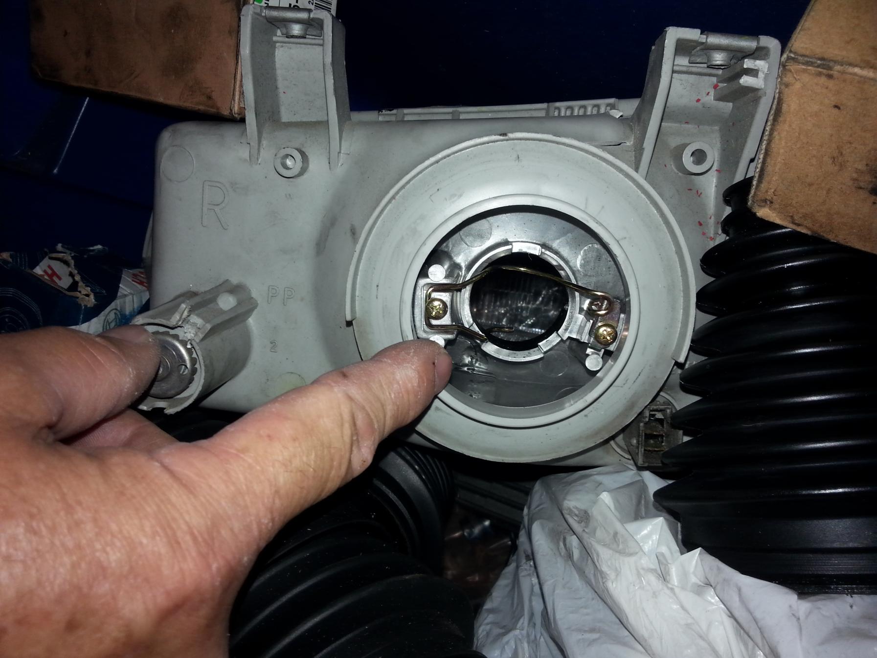

    Got the bulbs and had a quick look. Is there a nack to taking the old ones out. I can see the little metal bracket that is holding the bulb in. Do you have to remove the two screws? I didnt want to apply too much force trying to unclip the bracket.

    No need to remove screws, at the opposite end of the wire clip to the screws, the end need to be squeezed and unclipped from the headlamp housing. Where the screws are is a hinge which allows the clip to pivot out.

    tried this again I cant get the bulbs out. I must be missing something here. The one clip that hinges under the bulb is held in with some force.

    regarding the two screws, I loosened the one screw retaining the square section of the clip and the clip easily popped out.Click image for larger version.

    In the picture in the above post, it's the end of the clip to the right of the picture that needs pushing into the headlamp and then moving up to disengage from the metal clip and then hinging up away from the bulb to allow the tail at the bottom to lift away from the bulb
