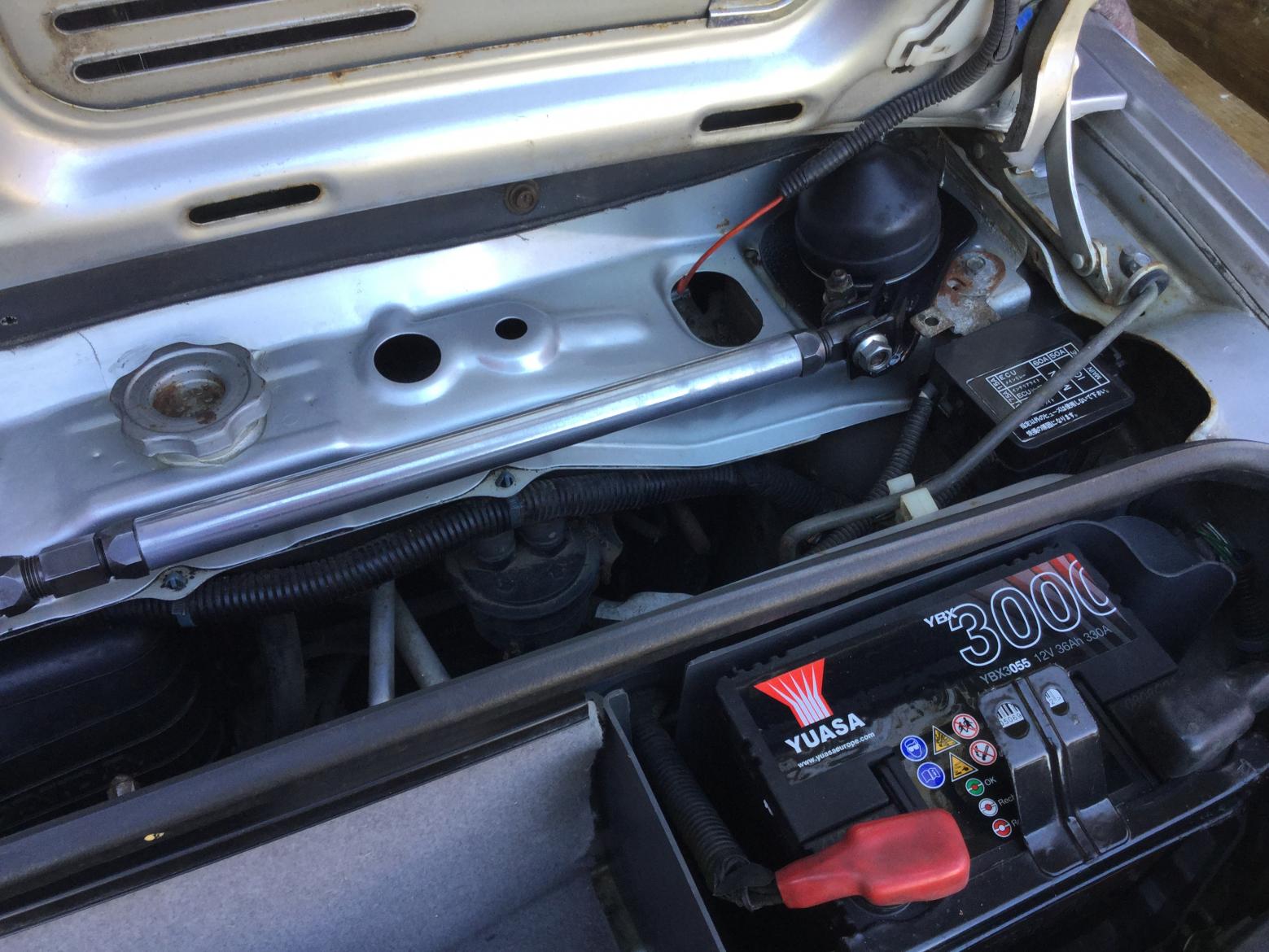

    yuassa ybx 3055 (l/h +) i paid 50€ delivered from germany (on fleabay)
    fits exactly, correct cranking amps, little japanese terminals.
    fits original battery box and battery clamp
    Apr 2017
    35
ID:	2712 hope this loads ok
