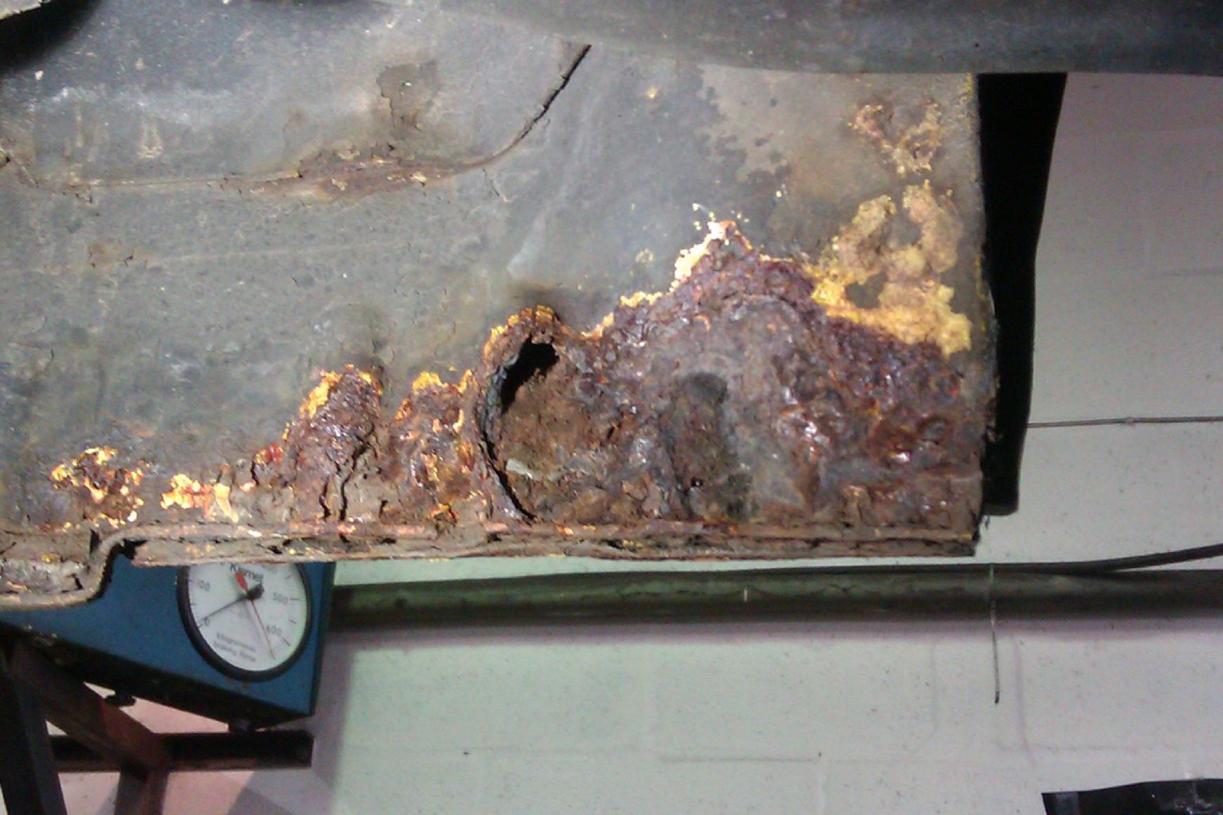

    rust is usually on joint inside door shuts or bonnet although mine has had small repair to inner sill area ds at rear inner

    this looks worse than it was...
