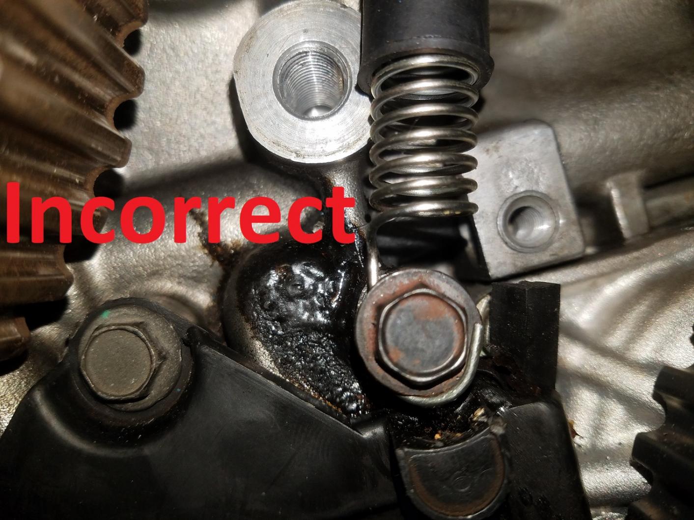

    Ugh so now the lower/mid belt cover is hung up on the water pump or something. I can't figure it out. All of the bolt holes and clips line up perfectly, yet on the water pump corner I can heat the plastic hitting something before it seals.
    Am I doing something wrong?
    Edit...I took it off and put it on again, and now the bottom clamps line up but top is slightly mis-aligned, and it appears to be a piece of protruding plastic is hitting or getting stuck on the bolt that hold the spring tensioner for the timing belt.

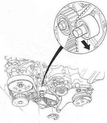

    Since everything seems to be aligned correctly but the tensioner spring and bolt seem to be in the way I am thinking my friend helping me (who accidentally unbolted it) put it back in the wrong hole.
    Are there any labeled diagrams of the timing side of the engine so I can verify this, since I can't actually see where the tensioner spring bolt is supposed to go?

    Mar 2011
    108
    this is the only diagram I can find - it might helpClick image for larger version.

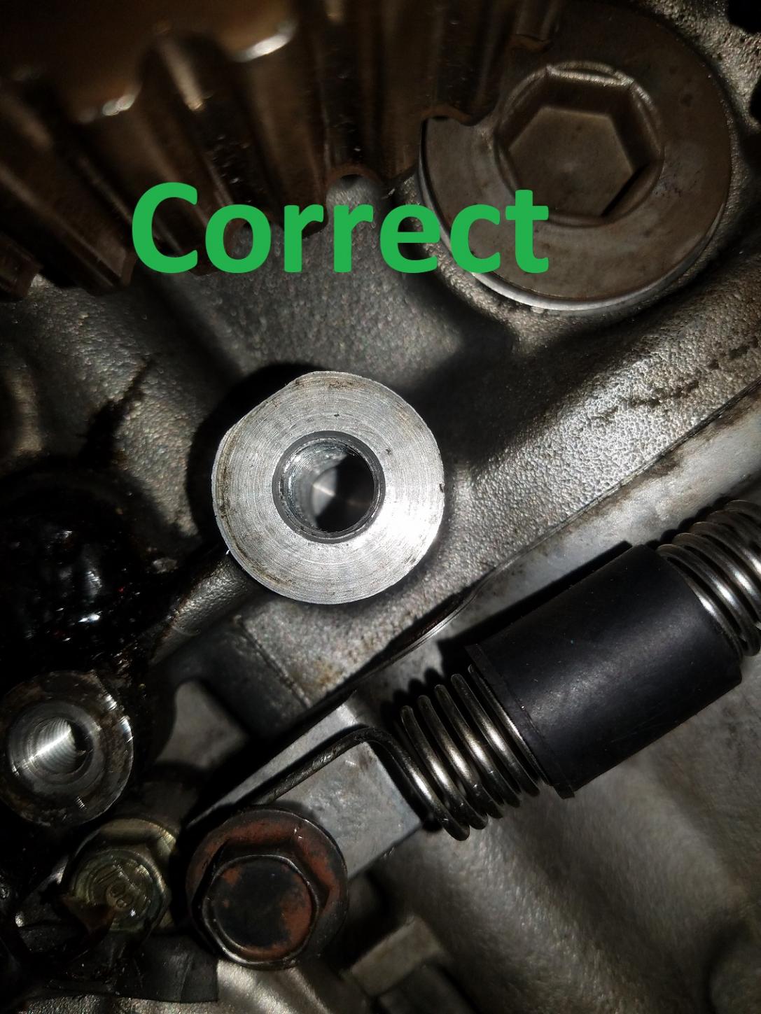

    I'll let the pictures do the talking.
