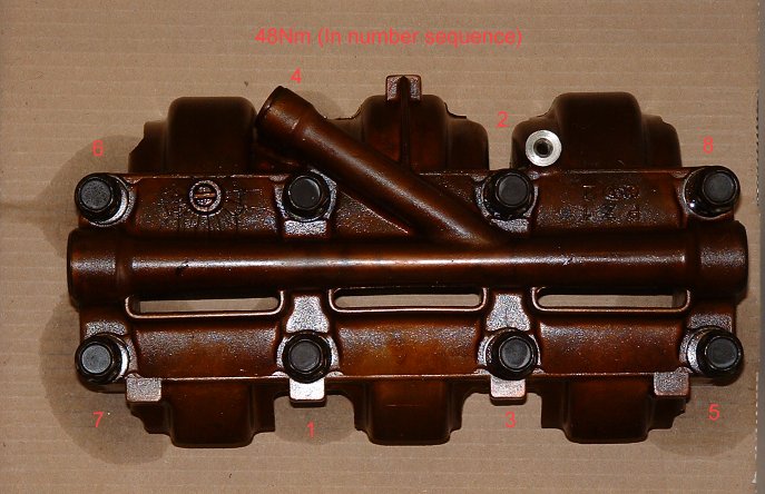

    Hi, i'm still having no luck with the tighnerning torques for the main bearing & big end bearing, so i thought i'd see if the ACTY van engine would be the same....??? still drawing no luck, even thou the acty was offically released over here,the service manuals are impossible to find ...
    i've been throu the jap beat service guide, but its just not detailed enough.... or am i missing something??? i'm in the 5-21 section??? is there another section to this exploded view??
    thanks for any help

    Bearing cap torque settings
    Hi there, two sequences to tighten the bearing cap.
    1st - Snug torque to 3.2kg-m in sequence.
    2nd - final torque to 4.8kg-m in sequence.
    If using original bolts be carefull as when the final torque is appiled the bolts stretch to perform bolt tension and maintain the crank oil clearance.
    Hope this helps.
    Kent
    1,500
    32Nm for Bigend bolts
    48Nm for mains. (tigntened in sequence)
Name:	Main bolts.jpg
